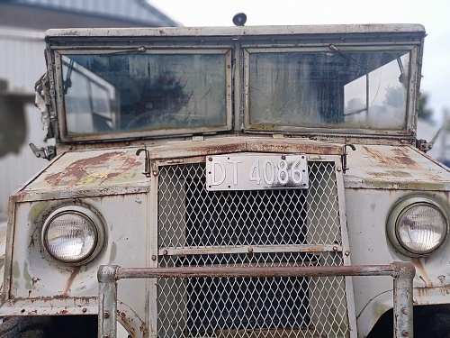

The panels include the faint outlines of hand brush painted "Mickey Mouse Ear" camoflauge pattern that will be mapped and redone as part of the restoration.

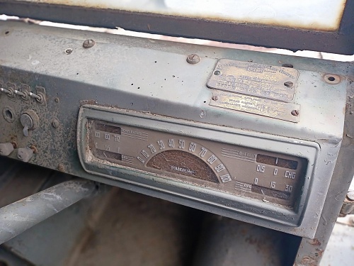

It has 17,200 original miles on the clock, with the rectangular pattern dash.

Here are the picis of the King Rat.
As I said the door markings and Mickey Mouse pattern are vey evident. The highly interesting part that isn't as clear in these pictures is that these were painted on by hand using a brush, overlapping round circles were used a close look at the fourth image will show this effect.

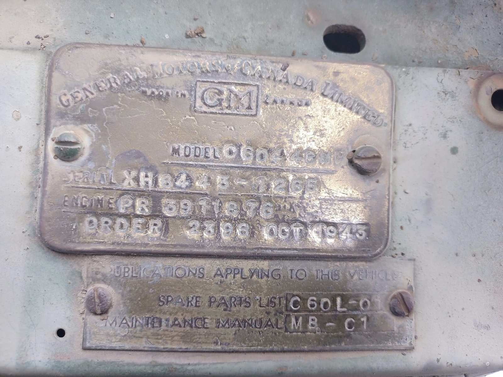

Plates details (stuffed some of the rubbing and didn't realise it but I think we have enough)
All three plated from General Motors of Canada Oshawa Plant.
1
Chasis Model C15441
Cab Model Blank
Chassis XH 8448-172
Engine No XPP386287
Order No 2396
Date of Mfg 5-3-43
Spare Parts List C8AX-01
Maintenance Manual MB-C1
2
All the same except
Chasis XH 8448-033
Engine FR 3862793
Wahoo 2 made on the same day.
3.
Dated 5-5-54
And I stuffed the rubbing up and can't read it. Oh well another trip needed.

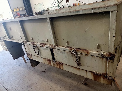

Picis follow of the trucks and rear bodies which are stacked against the shed. Note that two of the trucks have convoy lights and the rear solinoid for the diff light.
6 stud wheels and horizontal tow rings on the front bumper.

Old 19-12-23, 21:19
Posts: 14,930
Default Order No 2396
Another from S/M 2396
Source: https://www.facebook.com/groups/2802...4676703117781/
ID:	136636 Click image for larger version
ID:	136637 Click image for larger version
ID:	136638 Click image for larger version
ID:	136639 Click image for larger version
Old 20-12-23, 04:55
Posts: 5,259
Default Strange data plates......
Hi Hanno
Is this data plate typical of Australian/Holden assembly with the information clearly stamped from the front or top side........ and the Canadian factory ones are stamped from the rear giving raised letters????
re-reading that particular thread makes one realize how many precious members have since left this planet!!!!! ....I do miss them!!
