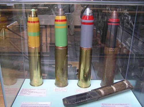

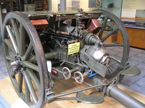

Old 13-10-11, 23:18
Marc van Aalderen's Avatar
Join Date: May 2009
Posts: 481
Hi,
Here are some pics of the original WW1 18 Pdr. before conversion to modern rubber shoes. These were taken at Firepower, the Royal Artillery Museum in Woolwich Arsenal, UK. I find the projectiles very large compared with the cases. One would imagine the range to be limited because of that.
