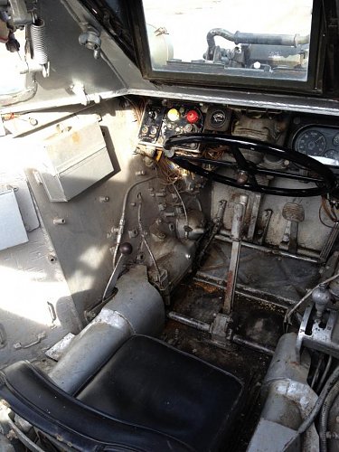

I am considering restoring it to 1956 Squadron 56 UNEF. That would mean a 19 set radio and a Bren Gun. I would not paint it white but rather the m-series semi gloss olive drab. The ferrets were painted white a few years after they arrived in Egypt.

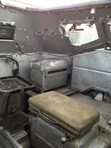

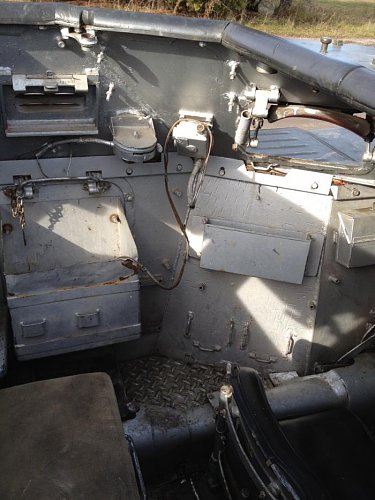

Some other interior pics.
ID:	45584 Click image for larger version
ID:	45585 Click image for larger version
ID:	45586 Click image for larger version

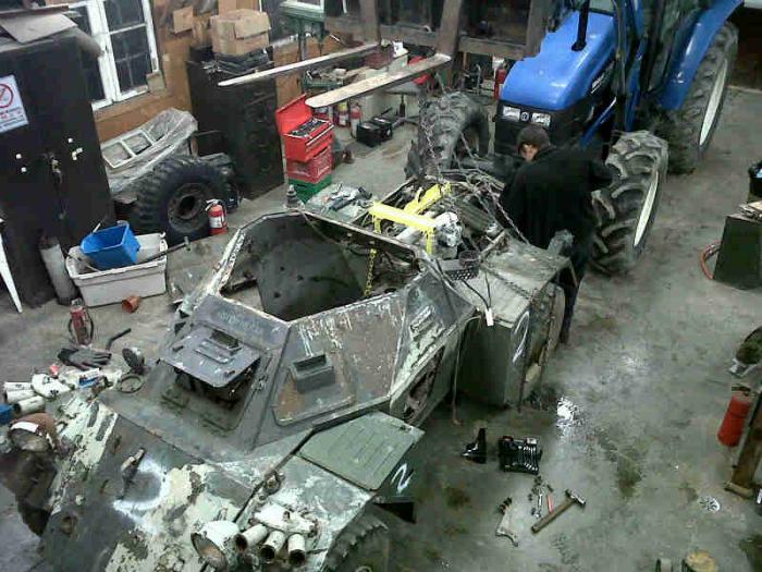

I'm sure that if you do a restoration you will end up doing what I am doing with my Canadian Mk1 Ferret call sign 31, a Strats vehicle.
I apologise for the lack of picture quality but here is the pack coming out last wednesday night. We had the engine running two weeks before.
Robin
ferret pack in air.jpg   ferret pack prep 2.jpg   ferret pack on stand.jpg   ferret dirty hull.jpg   ferret pack prep.jpg

Al,
Thanks for the sediment tip but yes I've done a Ferret pack re & re before and know only too well the laws of gravity and what lies under a pack.
Here is a fuel tank that will be the heart of any Ferret running problems.
Mine is back from being cleaned and tested and will now be put away sealed awaiting rebuild time
R

Hey Robin, what do you think the total weight is of the engine assembly?
Congrats Al,
1943 White M2A1 Halftrack (converted from an M4A1)

Give or take a few pounds the whole pack weight is around 1428lbs according to the manual.
The fuel tank is a very complicated assembly designed to maximise the usage of the space it occupies.

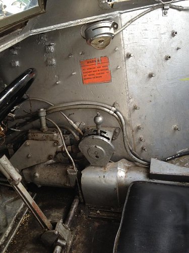

But I also noticed yellow paint on the steering box behind the wheel. I plan on going original so that would mean going with the yellow paint.
anyone seen this before?

think you mean BEVEL box
R
Old 26-12-11, 17:58
Alan Duffy Alan Duffy is offline
Join Date: May 2011
Location: Aurora, Ontario, Canada
Posts: 45
You are right!!! Next time I will finish my coffee before I write.

Al,
regarding the bevel boxes, it is the over enthusiastic painter who seals the spring loaded breather on the tops of them that starts all the aggravation. They are easily taken apart and cleaned and put back in.
R

From what I understand, the bevel boxes were painted yellow with a leak detecting paint.....it's easier to see the fissure. Good luck with the restoration. I have a little bit of knowledge on the Ferret, so if I can help with a problem, I will, or may know someone who can. If you need a muffler, I might be able to help aswell.
