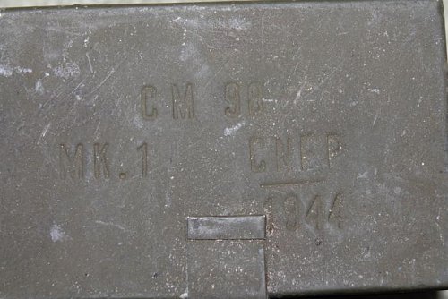

I recently came across 2 styles of these small metal boxes. With some research I have discovered that they are some sort of sniper spare part tins. They are marked as follows...
CM 98 MK. 1 1944 CNFP

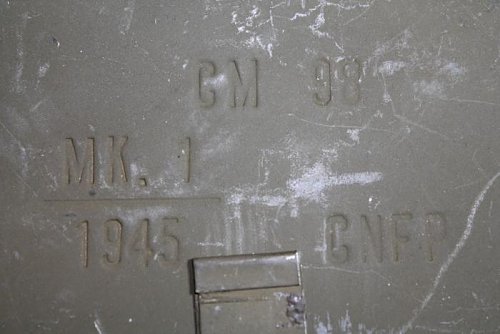

The second one is the same, with the exception of the 1944 being a 1945. They also both have a sea broad arrow stamped on them. Any assistance in further identification or explanation would be greatly appreciated!

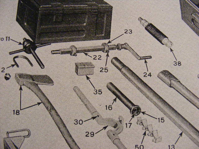

They are sometimes embossed as "spare springs" or something similar. They were a pretty standard British ordnance item and was listed with 25 pounders, bofors, etc etc to hold minor spare pieces. May have been issued to Mortars as well, cannot be certain. Bofors manual refers to them as "Box, spare pins, keep pins and insulators no1mk1. Part number is CM98.
See item no 35 in the photo below.

Hi,
CM 98 is an accessorie for the 25 pounder gun.
Designation is : BOX,SPARE SPRINGS,KEEP PINS,WASHERS AND
INSULATORS,NO.1,MK.1
cheers
