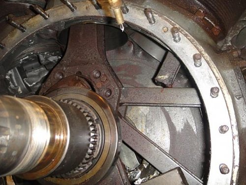

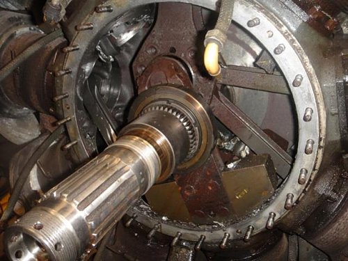

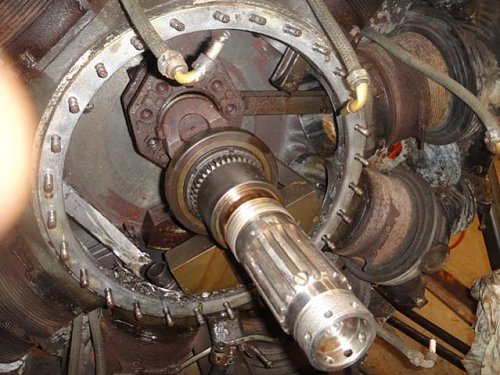

At the Oshawa military museum, we got the front covers off a sadly neglected R975-C1 out of the Sexton. We were expecting pistons rusted into bores but it was much worse. 5 of the 8 articulated rods are broken at the big ends (which, to my surprise, are actually the small ends because the knuckle pins are much smaller diameter than the wrist pins). The master rod bearing is also toast with about 1/16" clearance.
A number of pistons are all smashed up and each broken rod smacked the bottom of its liner on both sides as it was thrashing around so that the liner is mushroomed out, making it a pain to pull the jugs. The crank is a mess but surprisingly the crankcase looks intact.
Very disappointing. It probably makes a rebuild out of the question as we need a complete rotating assembly and probably 9 jugs. It's probably best to part it out and install a Detroit diesel to make the old girl mobile again.
Malcolm (using Cliff's sign-on)

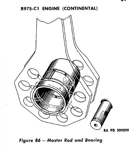

The 30psi at 800rpm is the oil pressure generated by the pump. There is almost no pressure resulting from the pump actually at the big end. The pump gets it to the main bearing, from there it makes its way by centrifugal force.
It strikes me that the oil passing from the main bearing into the hollow crankshaft is having to fight against centrifugal force, although after that centrifugal force is certainly helping it get to the master rod brg.
Even at 800rpm big end lubrication is marginal.
Certainly - with a hot oil idle pressure maybe around 10 psi and weak centrifugal force, I can see that.
There is no oil supply to either end of the slave con rods, they are lubricated only by splash.
The attached extract from the C1 manual below shows passages for force feeding oil from the master rod bearing to the slave rod big end bearings.

Sorry LRDG, I was wrong about the oil supply to the slave rods,I should have looked it up like you did ! And yes, I should have said 'greatly increased' rather than 'doubled' when trying to stress the value of the supercharger. The C4 had a different supercharger impeller and ratio in an attempt to widen the torque curve but it is hard to feel the difference between them when driving them.

Your engine definitely failed due to a worn out crankshaft main bearing, resulting from no oil supply due to incorrect operation as David says.

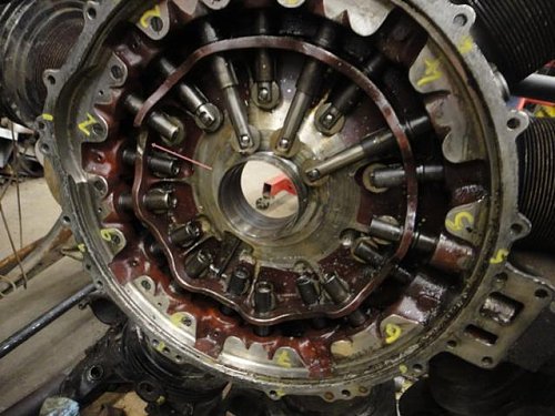

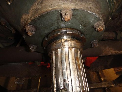

Bob, the engine is coming apart as we speak - a complete teardown. The bottom of most the cylinder liners have been mushroomed out by the broken rods (red arrows) so it will take some time to get them out without damaging the case.
The rotating assembly is scrap, badly damaged. If I have it straight, the output spline damage shown would have been from the engine trying to stop the Sexton dead when it locked up.
The case may be OK. We'll check it with dye penetrant when apart.
I take your point about carefully checking we are buying usable parts.
Are the very thin, closely-spaced steel cylinder fins as-cast? If so, they are very high quality castings. Spin casting maybe?

Malcolm- for whatever little bits its worth- those splayed out cylinder bottoms may be a pain to disassemble but maybe they will have saved the thin cast aluminium that makes up the crankcase. Later engines (eg the -46 helicopter) has much heavier castings in it. It also rated at 600 hp with much more blower and carb action. I cannot tell you about the fins, I always thought they were machined in but I don't know..Bob
Good point, Bob. You are right, they did save a lot of damage to the crankcase.
It's pretty well apart now and disassembly has stopped as there is some angst about repair costs.
There is some interesting damage to the crankcase in the raised web that supports the lifter bores. It's shown below. It lines up exactly with the inboard end of the starter drive shaft (last photo, 6 o'clock position). It's like the nut on the starter end of the shaft had come loose and allowed the shaft and small gear to move inboard and wear into the web. And it doesn't look like old damage because there is wear debris coated on the web that's not shown on the photo. It's like the nut came loose and when it was spotted (or heard), somebody just retightened the nut to pull everything back into place and hoped for the best. The weird thing is there absolutely no sign of damage or wear to the end of the shaft or the gear. It's a bit of a mystery to me.
Thanks again for all the suggestions on parts but things are on hold for a while.
