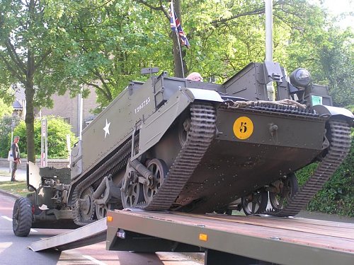

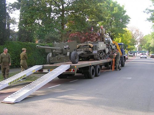

Originally Posted by gordon View Post
Anyone actually use a skip truck, or any other form of Carrier transporter we might learn from?
I've seen some carriers struggle to drive onto transporters or trailers over the years.
Hi, This is how I transport my vehicles. Carrier has no problems what so ever to climb the ramps even with the added weight of the 6 pr. The gun weighs in at 1150 kilo's.
ID:	63533 Click image for larger version

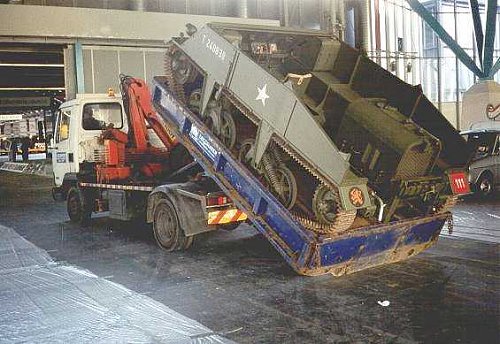

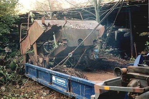

Here's a variation on a theme. Dirk is in the skip business, you can see he used one for the Loyd. First when it was little more than rubbish, really:
But also a useful means of transportation after it was restored:
