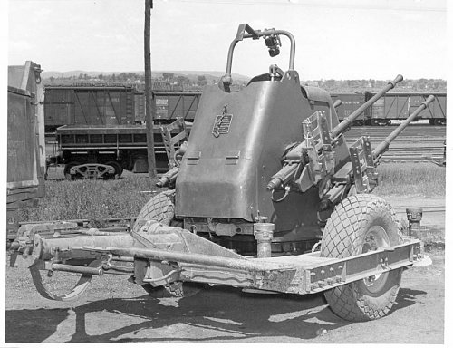

Default Inglis 20mm Quad
It was mentioned the gun was pitched to the British, but they were too heavily invested in the Oerlikon and Hispano to be interested. It would be interesting to know performance specs on the Inglis and how it really compared to it's two competitors.
The early 1944 British decision to use only Oerlikon 20mm ammunition is what largely doomed the Inglis 20mm, which was designed (following British advice) around the Hispano-Suiza round. By the time the Inglis gun had been adapted to fire Oerlikon ammunition, the war was over. There is more information on the various projects using the gun at LAC: RG24 , Reel C-8414 File 9012-520,Quadruple ack-ack mount and RG24 Volumes 10061 and 10062 13/20 MM series, as well as among the ATDB reports at DHH (115.41013)
Name:	20mm quad pilot 1small.jpg
ID:	65928 Click image for larger version
Name:	20mm quad pilot 5small.jpg
ID:	65929 Click image for larger version
Name:	20mm quad pilot 2small.jpg
ID:	65930 Click image for larger version
Inglis

Hanno: Give me a couple of days to borrow back the article in question from the friend that lent it to me and I will get back to you. I think there was actually a photo of the vehicle in question sitting somewhere in Holland, minus the quad turret mount at the rear.
Roger: Thanks for posting the photos. This gun is getting more interesting all the time and it is nice to know the concept of changing specs in the middle of a project and then killing the project, is not as modern a concept as we might like to think.
