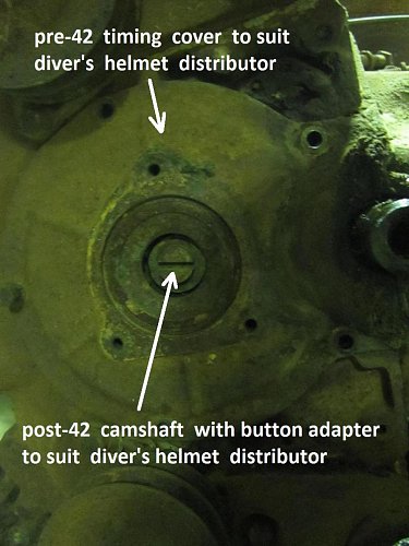

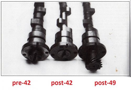

I think there was some talk about different length cam shafts for different distributors
Yes, the pre-42 camshaft had a longer nose to suit the diver's helmet dizzy. The post-42 camshaft had a short nose to suit the crab dizzy.
Aftermarket adapters were available to convert between the two types of dizzy, without having to change the camshaft. When converting a pre-42 motor to a crab dizzy, a spacer adapter was used. This fitted between the timing cover and the dizzy, moving the dizzy forward to accommodate the longer nose on the pre-42 camshaft.
When converting a post-42 motor to a diver's helmet dizzy, an extension adapter was fitted to the nose of the cam. This is the adapter seen above. In other words, it's a post-42 camshaft adapted to suit a diver's helmet dizzy.
Of course, it was also necessary to change the timing cover, because Ford changed the bolt pattern as well as the camshaft nose.
It's unclear to me why Ford made these changes. It would have been much simpler to design the crab dizzy to fit straight onto the pre-42 motor. It's as if they went out of their way to prevent interchangeability.

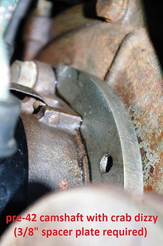

Well after accidently putting a hole in my radiator while trying to get the fan shroud out and a fair amount of cursing and that's because I thought I could just do the job on the carrier without taking much apart. (WRONG) I had to take the radiator out to repair it and that was so much easier to change the timing cover over. I found that I needed to make a spacer plate that is
3/8" thick because the back of the crab dizzy is longer than the bell. The button extension in the picture above is not the correct part as you "WILL" need that spacer. They probably are available from the speed shops but I made a very basic one from a piece of 20mm plate. You learn something everyday. It will all be worth it at the end of the day!

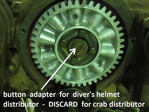

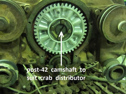

I found that I needed to make a spacer plate that is 3/8" thick because the back of the crab dizzy is longer than the bell.
Colin, you don't need a spacer, you just need to discard the button extension. You only need the spacer if you have a pre-42 camshaft. Your motor has a post-42 camshaft, so the crab dizzy will fit straight on. Someone in the past has converted it to use a divers helmet distributor, by fitting the button extension. You just need to undo the conversion by removing it.

Hi Tony and thanks for the great information. I do in fact need the spacer as my engine is a pre42 model. The engines that I posted are just a photo of a couple of engines I have for parts. The carrier I'm upgrading has its original engine which does need the spacer.

Sorry Colin, I assumed the motor was the one with the new timing gear. I should have known you'd be on top of things! Nice job on the spacer BTW, I had a lot of trouble finding one last year. No one had ever heard of them, until finally I got onto Mike Davidson of Flatattack Racing in SA, who still had one lying around. I have an earlier type on another motor, it's cast alloy and shaped like the gasket. No doubt these were common in the '40s and '50s for rodders converting to crabs. I haven't come across the button extension before but I knew of their existence. They'd be quite rare I imagine, as very few rodders would swap a crab dizzy for a divers helmet. I suspect they were used when fitting a post-42 race camshaft into a pre-42 motor. I notice there's a stamping on the nose of that particular camshaft, which is what the racers did when they ground special cams. They used their own codes so no one knew what grind they were running! I wonder if it's a reground camshaft, they often made their way through several race motors as each one blew up!
