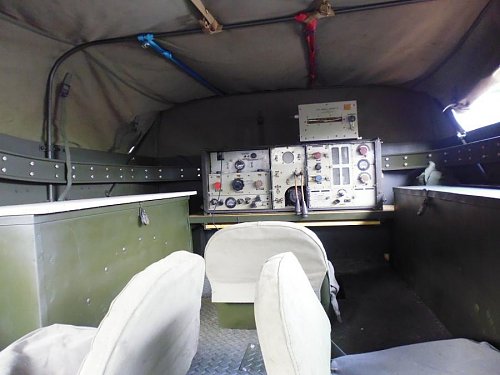

WS9 installation in the back of my White Scout Car...
Still need to find a few bits, key items are:
Set to ATU cable (Not sure designation)
Power Cable (Connectors Twin No17)
Spare Valve Case
Tim

That is a very nice looking wireless set, Tim, and it looks quite at home in the back of your Scout Car.
The only other photo I have seen of a WS9 was of a Canadian version, and there was not much to see of it. The front was covered by a pair of either very stiff canvass, or metal covers, with cutouts for the key knobs etc.
Well done!

Mine is the Canadian WS9... installation has been based on war diary records that the Canadian WS9 (Mk1) was fitted in the White Scout Car, veterans recollections, and a nice photo of the Canadian WS52 (WS9 Mk2) in the back of a White Scout Car in a similar position, though not enough of the photo is clear to see exactly how it is installed.
Looking for more photos and any spare parts.
