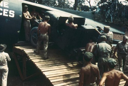

Old 16-10-21, 01:26
m606paz m606paz is offline
Mariano Paz
Join Date: Jun 2009
Posts: 823
AEDB File Volume 5
Mariano Paz
Buenos Aires, ARGENTINA
1944 Ariel W/NG
1945 FGT FAT
Old 16-10-21, 02:04
Last photo: Is that Dr Indiana Jones?
Old 16-10-21, 02:04
AEDB File Volume 5
That Ford turned into a Chev once loaded on the C-47??????
Old 16-10-21, 15:05
Default Don't understand the logic of cutting the nose
Hi
Given how easy it is to remove the entire nose why take the time to cut one corner off?
Yes that's all they needed to fit through the door of the aircraft, but it would take about the same amount of time to unbolt the whole nose assembly as to unbolt the corner.
Very interesting set of photos and the change of sex of the truck mid way shows they were workings with both Ford and Chevy. Now this must have lead to some interesting mix and match parts problem at the other end of the trip. Or where they careful to only remove parts that were interchangeable.
