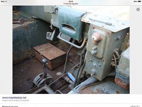

On another note, perhaps worthy of a new thread I have given up on my regulator box. In fact both mine and another take off neither if which work.
On the T16 the regulator looks like a Jeep Delco but has a clamp over it and the contacts are sprung copper plates. I want to replace it with a modern insert and wonder whether anyone can recommend a suitable kit? I know the dynamo is working fine . I have bought these for old motor bikes Perhaps they are available for big boys toys?

Contact Bert van de Bult via http://sixvolt.nl/en/, he builds electronic regulators which go inside the original housing

Andrew, Do you mean Autolite? Jeep and Dodge Used Autolite electrics (standard Quarter Master Store stuff) Delco is General Motors.(Chev, or in Britain,Vauxhall / Bedford)
Old 01-12-15, 00:31
andrew honychurch andrew honychurch is offline
Join Date: May 2010
Location: Kent, Great Britain
Posts: 362
I probably do mean Autolite actually, yes! Getting old and tired. It doesn't have a tag on it but it is very like a Jeep regulator other than the clip top and spring contacts.

http://s714.photobucket.com/user/van....jpg1.jpg.html
Here is a shot of the T16 regulator for reference. Sorry it's a poor photo

There were two types of regulator housing. The one with clamp around the center is the T-16 early pattern. Latter looks just like those used in a jeep but it has higher capacity guts being 12v 55amp which were the same as found on the U.S. half-tracks.
Vintage Power Wagons in the USA produced electronic replacement guts to fit the regulator housings. Not sure if they still make them or not but it's what I had in my carrier.
http://www.mapleleafup.net/forums/showthread.php?t=9136 Message #161 in my old carrier restoration thread shows the later style regulator housing for reference. Guts should fit in either housing though since its a digital circuit board.
