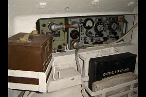

Old 02-03-16, 20:11
Adrian Barrell
Location: Suffolk, UK
Posts: 862
That installation diagram is a 76mm and a little different to a Sherman V. The last photo is mine.

Ahhhh! So is that the same installation in yours that Patrick is after? And how do you keep it so damn clean in there? As an aside, was the filming of Fury tough on it?

Yes, I'll take some pics for Patrick. It has never been that clean inside since I took that picture and yes, Fury was a little tough, though apart from a noisy starter Bendix, she sailed through all the filming.
