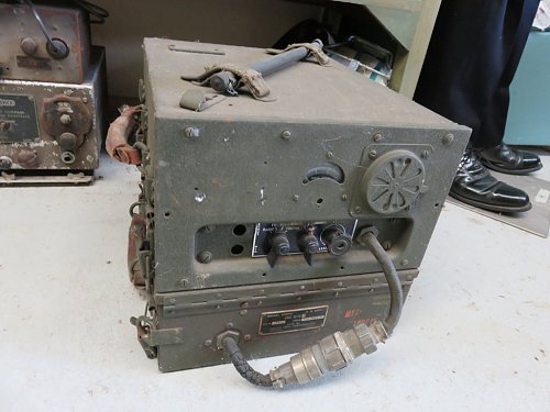

I have a few wireless items in the museum and I must admit I know nothing about them.
I thought I would start a thread 0r two and list them for your identification and comments.
I have about 20 items, so it is over to you experts in this field.
Looking forward to your replies.
No. 1.

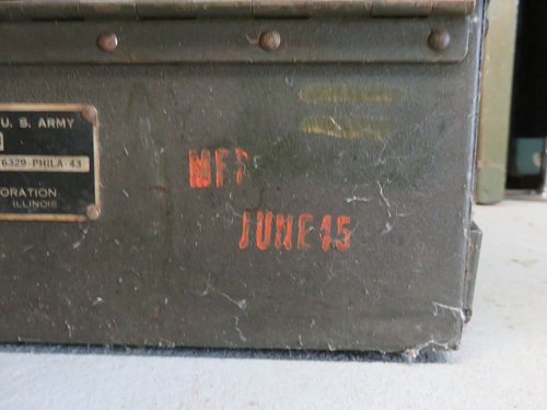

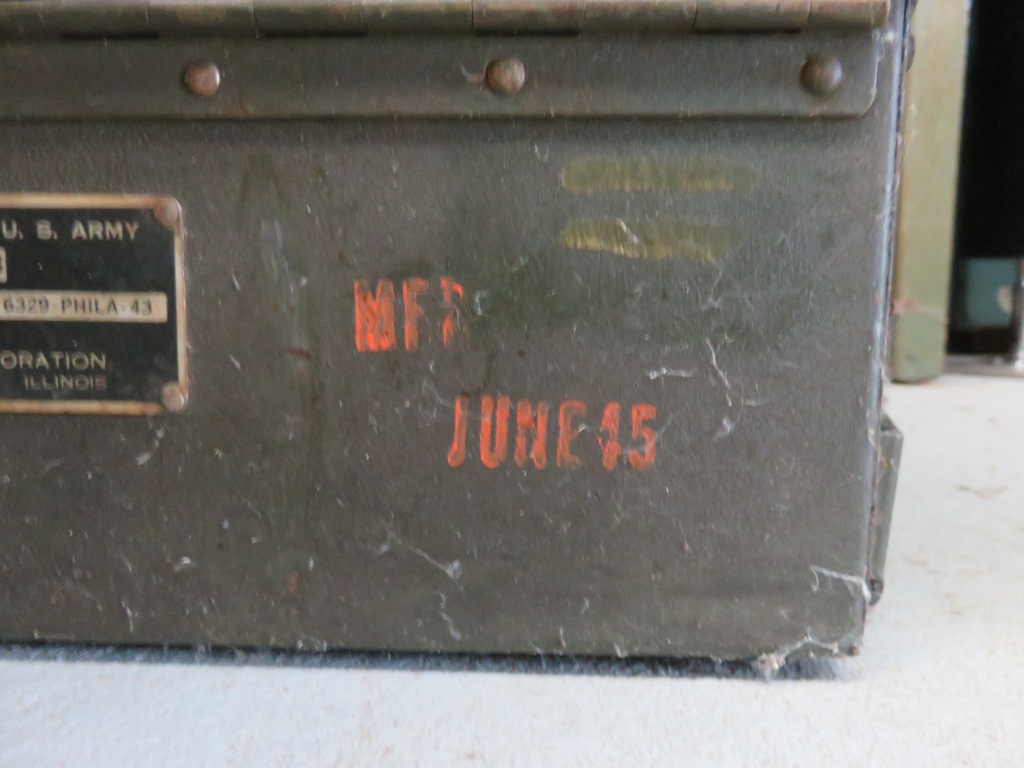

US designed BC-620 radio set. Early low band FM transceiver for mobile use. May also have been made in France under license for use in Indochine.

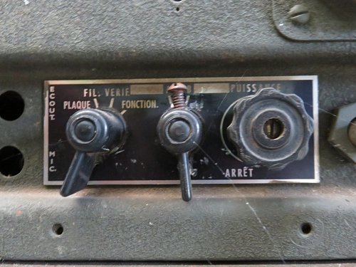

The two knobs are not original, they are typical AWA made knobs.
Many Jeep restorers call the BC 620 the "Jeep radio" . I've seem them in restored Jeeps here but the BC 620's around the club scene typically have been imported from France or the USA in the 1980's and later . I don' t recall seeing any evidence of in use in the SWPA but maybe the yanks did .
