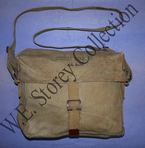

Here is an example of a Signal Satchel with a ZA number.
Name:	Signal Satchel.jpg
