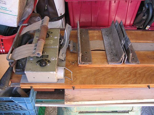

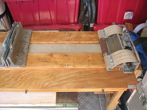

I am interested in the junction box. Could you post a better picture of it please?
and the wooden mounting board if you could? I would be interested in seeing if I could make one for mine.

Jason.
Two or three years ago, somebody in either the UK, or Western Europe, was making excellent reproductions of the No. 23 Carrier. They might even have been mentioned somewhere here on the forums.

Default Carrier Wood
Originally Posted by Jon Skagfeld View Post
Wow!
Who would have thought that "old" radios/comms equipment of a certain era could take a year to demonstrate/display/explain?
Good job Bruce. Many thanks.
Looking forward to the index so I can file it away in my favourites for future reference.
Sorry no measurement but have two picturesClick image for larger version
Name:	Base No 3 (1).jpg
Name:	Base No 3 (2).jpg
