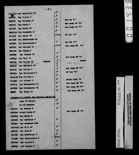

Hello,
I'm hoping someone can help me decipher some information I located in the XII Manitoba Dragoons online War Diaries?
I'm looking to find out what OP CAC "C" means. The XII MD War Diaries this as my great uncle's "trade".
For context, I believe he was a crewman in Staghound F235390 C-152, C-Squadron, 15th Troop.
(T-12714, Image 1511)

I've Googled and searched the MLU forum but have yet to find exactly what the designation means.
Any help would be greatly appreciated!

This means the radio operator. In the Strathcona war diary a Sherman is crewed by a driver, assistant driver, gunner, loader/operator and commander. If the crew positions were standardized across the armoured corps at the time he was the loader/radio operator in a Staghound.
"CAC" is Canadian Armoured Corps.
I don't know if the "C" relates to his squadron, perhaps if you had the complete document it would provide that information.

Driver mech would be Driver Mechanic, which was shortened to D&M by the 1970s. Rather than just operate the controls, the soldier was expected to do 1st line maintenance too.

At one point during the war, trades were grouped alphabetically. "A", "B", and "C" groups. The trade of driver mechanic, driver operator, motor mechanic were classified across these trade groups depending on the degree of qualification.

Thank you all for the responses! I'm sorry I can't offer any contributions to the forum on the restoration side of things but I knew this would be the group to ask about my Uncle!
Marco... that's my Uncle 2nd from the left! That is the only other image of him during his military service. You have no idea what this means to me! Thank you so much! And to see him with the rest of the crew is amazing!
