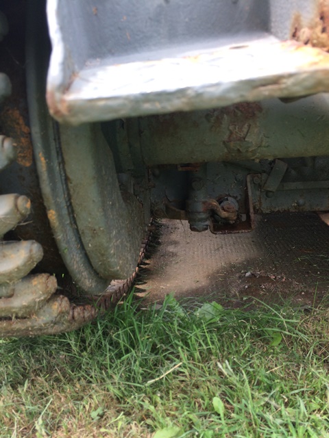

Here are the pictures...

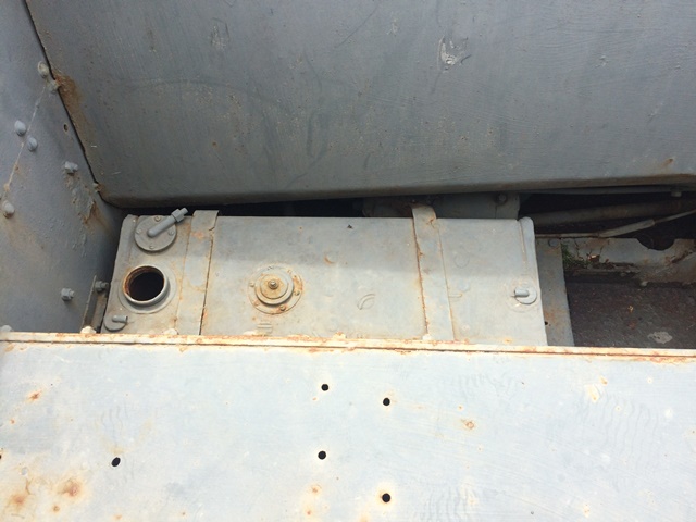

Pictures of the interior...

There were a number of Universal carriers collected by 2VP back in the latter half of the 70s. They wanted one for their parades, which I presently have here in the museum workshop. To save some measure of time, they moved the mk1 armour onto a mk2 hull, and then kind of tossed brackets from either mark wherever it suited them. One of my early Sgts was on that project, and as well there was a scrapbook in the duty center of 2VP showing the collection and repair of the vehicles.
I suspect yours may have been made up of some of the residue after this one was completed. I note some mk2 stuff on it, although the hull appears to be mk1. It does appear to be an uncut hull though.

If you are looking for the War Department Census number it will be on the vertical armour plate in front of the driver. Stamped into the top edge. See the image from the manual for details. Thus is the wartime version of the CFR. The specific wartime history of the carrier will unfortunately elusive but with the numbers you can find some of the appropriate markings. With Robs valuable 1970's/80's history it's pretty certain that the carrier never left Canada during the war but it might be worth an email to the PPCLI just to be certain morso just for due diligence.
For generic wartime PPCLI I don't have them on my phone but I'm sure I could dig something up for you.
If the R22R "owns" the carrier and hesitates about maintaining it don't be afraid to keep DND DDSAL and DHH in the loop. They control many of the monuments on and off of bases that aren't specifically owned by associations or national museums. If there is a lack of apatite to maintain it I'm sure other Units or DND museums would be anxious to preserve it.
If you are looking for durable outdoor coatings there are many on the market that will protect the steel if applied properly. For the most appropriate course of action for immediate outdoor preservation I suggest you contact the Canadian Conservation Institute in Ottawa. They are a federal government asset that is mandated to provide guidance in this exact type of preservation situation. They have approved lists of coatings that will protect the steel and to a certain extent rubber components.
I would love to see another carrier running but I honestly would be just as happy if you could keep it displayed maintained and stable until a long-term goal of full restoration could be fulfilled.
Old 20-06-17, 03:12
We have a mk2 in the collection that has been badged to PPCLI markings from Italy. My own carrier was also badged to them from when I loaned it for their change of command parade a couple years back.
The carrier at the citadel, as Jason has mentioned, was most likely a domestic carrier recovered in either Manitoba or Saskatchewan. As such, the CT number on the front armour would not have been used on the carrier but rather either the early or later DND numbers. The Ford of Canada plate on the division plate would indicate the carrier is post 43, so would have had a DND number in the format of 50-001 or higher. Careful sanding around the sides of the armour might well reveal the numbers if the vehicle has not been sandblasted. Occasionally there were unit markings, but just as often there were not.

Good armour bones to start with ... How does it look under the engine covers?
How often do we see the MK-I* with the single POL rack in the rear compartment, gunner side, over the track guard? So far, one other in the MK-I* located at the Ditsong Museum, J'burg, South Africa.
