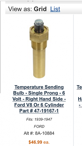

Harle,
If this is what you are looking for, Macs Auto Parts has them.
Peter

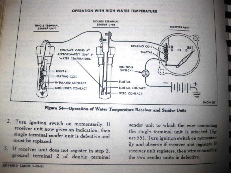

The talked of diagrams. All mixed up and random. You work it out. The last service bulletin supports Tony's comments (from 1939)

Hi Tony,
I stand corrected on the use of the double contact sending unit pre-1949. I should look at more post war Ford passenger car engines and not Ford truck engines. I agree however it seems stupid to not fit them to the Military engines.
Reading the service bulletins and looking at the diagrams kindly posted by Lynn. the second dual terminal sending unit (temperature switch) is installed in series with the single terminal sending unit. It is factory preset to open at 195 degrees which results in infinite resistance- ie no current flow to temperature gauge and a resulting full deflection of the needle to "Hot" So it cannot produce a variable resistance, only produce an open or closed contact.
Service Bulletin states:
"It is merely a circuit breaker which opens the circuit at this pre-determined temperature so the dash unit reads hot. It does not control dash unit operation at temperatures below this point"
So in effect it is just an "idiot light" switch as mentioned in the HAMB thread. It will not indicate the actual water temperature in that cylinder bank. It only makes the dash unit's needle show Hot when that cylinder bank's temperature exceeds 195 degrees.
Still, I personally would rather have some indication of both cylinder banks water temperature than just that of one and none of the other.
