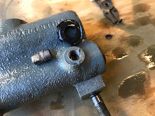

Don't use the new master cylinder #5454576E as it has insufficient volume and requires excessive travel and while i'm hesitant to say defective the hole in the side for the sensor lines up with the seals which then tears the seals.....
