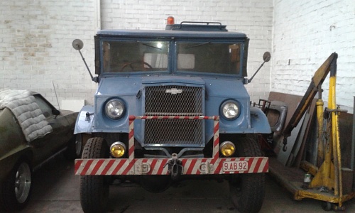

hey all, I'm new here and this is my first message.
we are working on a chevy c15a waterbowser in Belgium. here are some photos already. sorry my English is not that good.

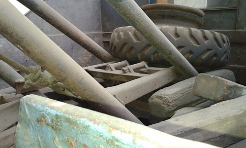

I have already stripped the chevy and encountered the following things that I have not seen on another chevy here some pictures.
the canvas flaps were mounted on the bottom of the cabin and thus protected the master cylinder from dirt. so on the other side there was one.
the metal tray has split pins for I think protective felt.
what would it have been for? , does anyone have an idea ?

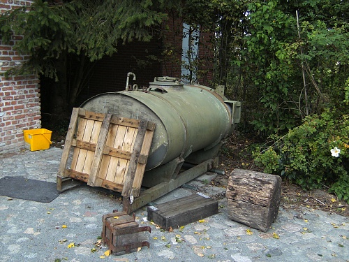

the previous owner had dismantled the water tank and sold it to a local farmer in the 1960s. I had seen this water tank per accident under a shelter of a farm and the ball was rolling and so I came to the original water tanker (tow truck).
unfortunately the garage owner has thrown away many original parts 5 years ago.
such as filters and hand pumps that are so hard to find.

the sawn-off rear compartment was mounted on the passenger side instead of a fuel tank. unfortunately there is a piece of 10 "shortened from the top, in the frame there is also a hole, is this hole provided to allow the cardan shaft to continue for the drive of the power pump? Does anyone have an idea? power take or is also present at the transmission, it used to be used to power the winch.
I think the winch is the same as on a ford gtb mounted.
