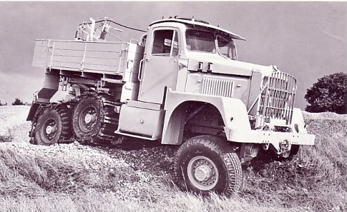

The business end is the same as a regular Scammell Explore, I have attached a picture of one minus the lockers.
Scammell did a lot of small series production vehicles, so its "dangerous" to say the cab determines the type.
The same cab is also used on the 4x4 Mountaineer.
Furthermore the constructors (in your pictures) do not have the walking beam rear suspension like the explore.

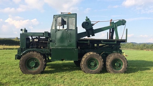

Just some clarification - as the truck is a "Wrecker" the business end to me would be the lifting arrangement..
Kind Regards

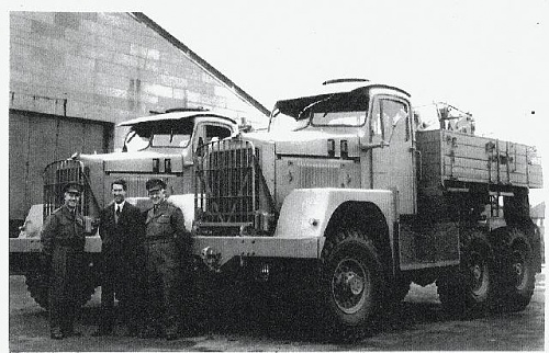

there isn't that much to see on the business end
