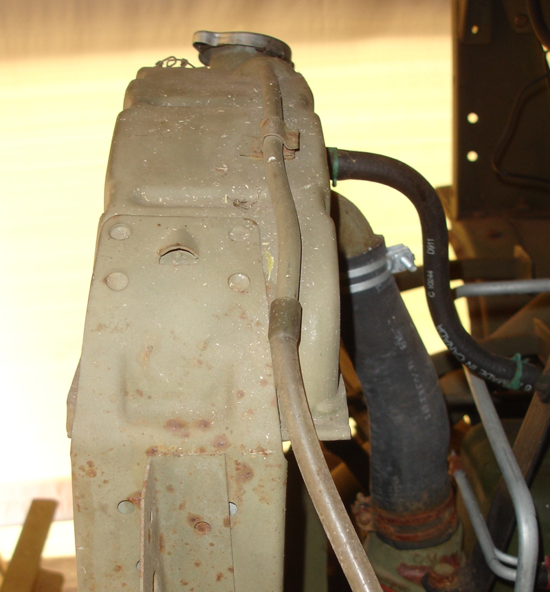

Thanks Phil, could you give me a diagram or photo of the overflow pipe from the centre of the top tank to the point where it connects to the hose to the overflow tank. I want to determine the shape & length of the copper pipe & how it is supported i.e. where it may be soldered to the top tank or side strap before it connects to the hose. Thanks Ken.
Old 15-04-18, 03:38
Two images of the radiator in my Cab 13 C15A.

Hi Grant thanks for that. Exactly what I needed. I will take it to the radiator shop tomorrow. Ken. And thanks again to Phil.

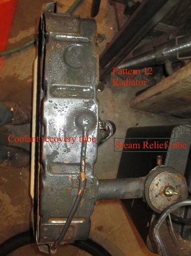

This is why I have enjoyed MLU for all these years, a question gets asked and answered in short order. Grant beat me on the photos of the Pat 13 Radiator recovery and seam relief tube locations, so below is the top tank of Pattern 12 Chev Radiator which is different.
Name:	Pat 12 Rad.jpg
Please post some photos of your new radiator.
