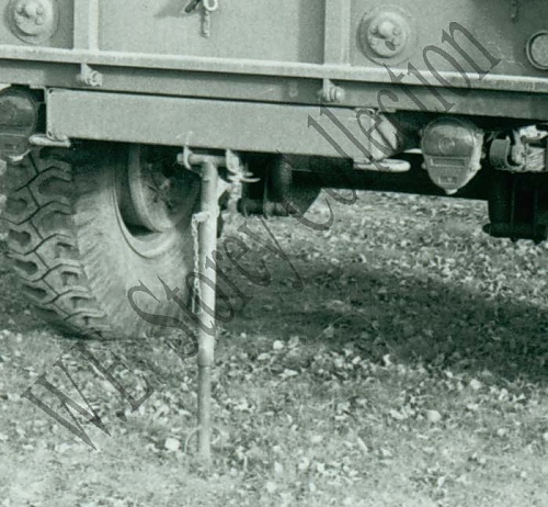

Hi guys I bought an old mlvw M104 CND3 trailer and its missing the rear trailer leg i doubt i would ever find one for sale so i thought i would make one. Im looking for pictures of what the leg looks like to help make it as authentic as possible. It also did not come with a intervehical wiring connector there is just a screw on wireing plug on the frame where a plug would screw into and the other end would connect to the mlvw maybe some one would know if this is some kind of standered plug that could be found. one last thing it came with the old firestone tires on split rims would the newer mlvw wheels fit on the hubs without modification if i could find any?

Wrt the stabilzer leg, I'll get you a photo of one next week when I am back at work.

Old 18-08-18, 03:02
Posts: 1,742
Default M104CDN3 Trailer Leg
This image may help.
Name:	127-23 M104CDN3.jpg

Tyson, PM sent regarding an NOS rear trailer leg. .. Brian

Tyson, Have you managed to sort out your missing trailer leg? Amongst some spares for an M532 Laundry trailer that I have I've got a couple of these legs. They look very similar to the one that you're missing but the method of securing when retracted may be different. PM me if you're still looking.
