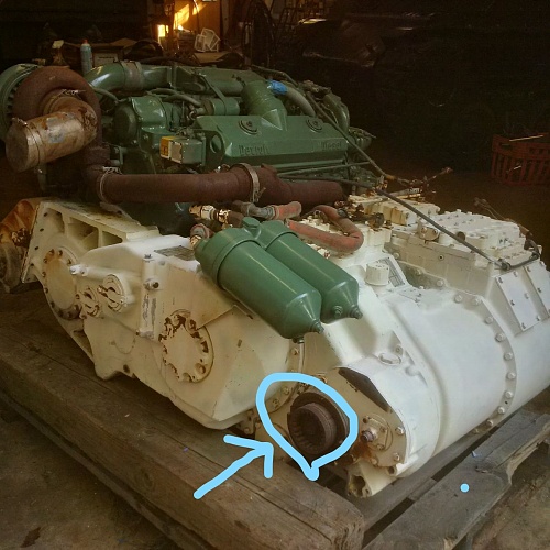

Exactly...its the splined part of the U-joint assembly that slides into the transmission I need to identify...
if I had this part of the U-joint holder for both sides I could fabricate the rest

The output shaft flanges shown in Rob's post #12 do not look compatible with the transmission shown in John's photo in post #11. The flanges in the drawing look as if they have a rather smaller internal spline than the larger external spline that would be needed to plug into the transmission in the photo. Am I missing something ?
I have an idea which could be completely wrong that M107 / M110 SPGs and M578 ARV have a very similar power pack to the M109. If so could John's photo be of one of those ?

I am pretty sure the pack came from a M109, that being said it is definitely an Allison XTG-411...perhaps there is a further piece that attaches to the transmission I am missing?

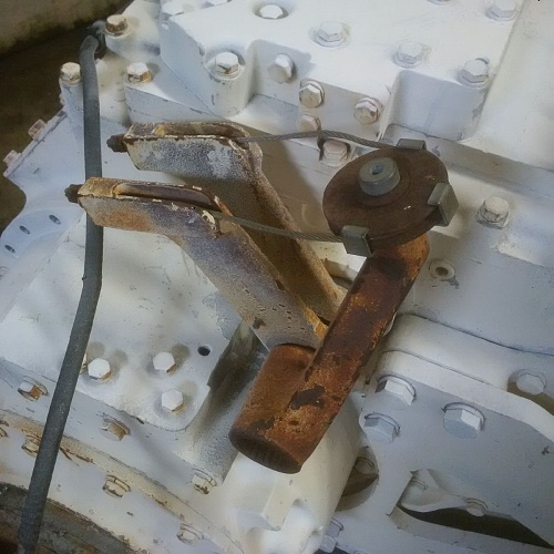

And I believe this is the steering...

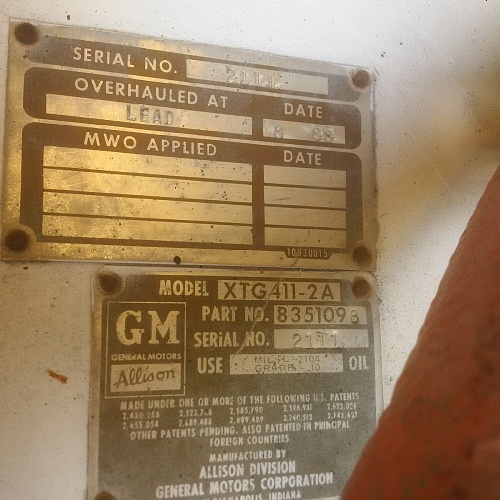

Attachment 101850
TM9-2520-234-34P gives 6 different setups of the XTG-411 xmsn. The first three are for the XTG41-2a like you have. Two of them are with a coupling, one of those is with "drive assys, output left and right", and one of them is with a yoke/adapter by the number I listed earlier (2520-00-736-3581). So your transmission may not be out of a M109.

John, I THINK that the photo you posted in post #19 is the equalising mechanism for either the service brakes or more likely the parking brake. I stress though that I have no literature or experience with M109s
