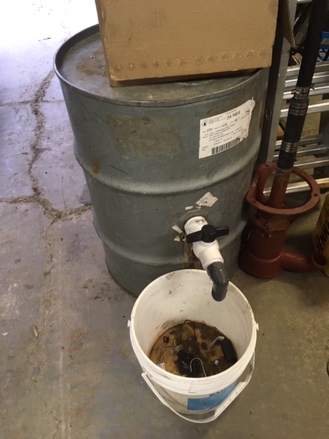

For the first time in my life i bought molasses in bulk . Why ? Who gave me that idea and for what ?

First let me ask a few questions . Should the links and pins be completely covered with the molasses ! How long should i let them stand in the bath ? I intend to use the pressure washer to clean them once the treatment is over . Is it a good idea given water will bring rust ? Should i use paint tinner ?
Now the source. I went to a local feed store . It is a coop run by and for local farmers . I buy tractor parts and feed / salt licks for my deer / moose hunting there . The regular molasses is for mixing with animal feed . The price is $80 for the molasses and $ 29 for the barrel and plumbing ( faucet/ spigot ) . If you return the barrel they refund you the $20. If you are good with the clerk , he / she will sell you the barrel that is past the best before date or that was contaminated and is improper to feed to animals . All the molasses sold for animal feeding is not proper for human consumption.
I paid $50 for the spoiled batch i bought and my spare tracks are bathing as we speak in 20 Gallons of the stuff. Sweet smell in my hangar ...

Only question that remains is how much water do i add to the 20 Gallons of molasses i have already poured on the tracks ?
Any ideas, suggestions, guesses ?

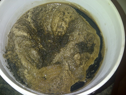

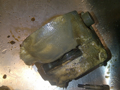

I did it with a ford dist timing fixture, ran the pics here a few years back. brilliant process.
Mixed about 25/75 water, just watch the fun happen.
pull some out after about a week and do a test clean..you can always put it back.
Didnt touch brass, paint, or, surprisingly, decals..
It will rust quickly after you clean and dry it..

I too have had track in Molasses, almost a year now with good results. The track was brand new however had been garden edging for 60 years at a guess. It is due to be taken out and waterblasted again soon as it builds up a black slime whilst soaking. I am unsure of the ratio however two 20kg containers of molasses is all I could afford at the time. soaking in a mix all up at approx 700 litres.
I did smell sweet for a while now it is something un human. I have it at work well ventelated next to a golf course and often see golfers checking there shoes for dog shit😂.
