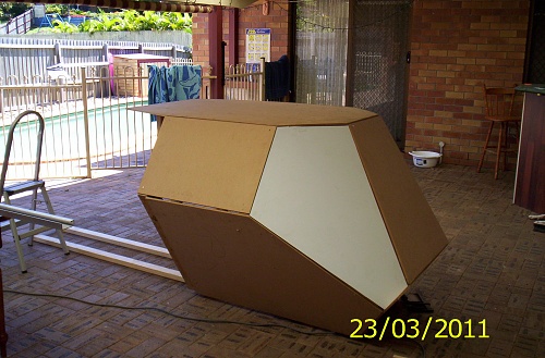

From the book, plans were magnified to quarter scale and with the help of my father who is a carpenter I worked out the angles and upscaled measurements by four and we made the mock up out framing pine and 9mm MDF

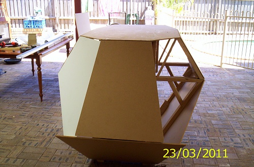

Sorrry about order here two pics showing internal setup

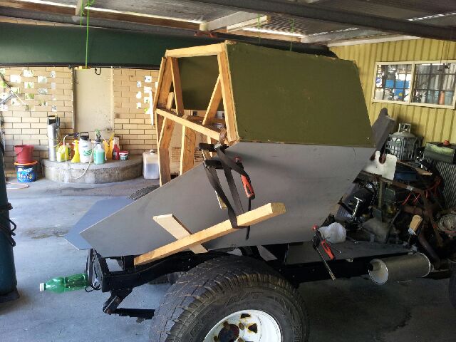

Hull was then put on chassis to ensure correct fit

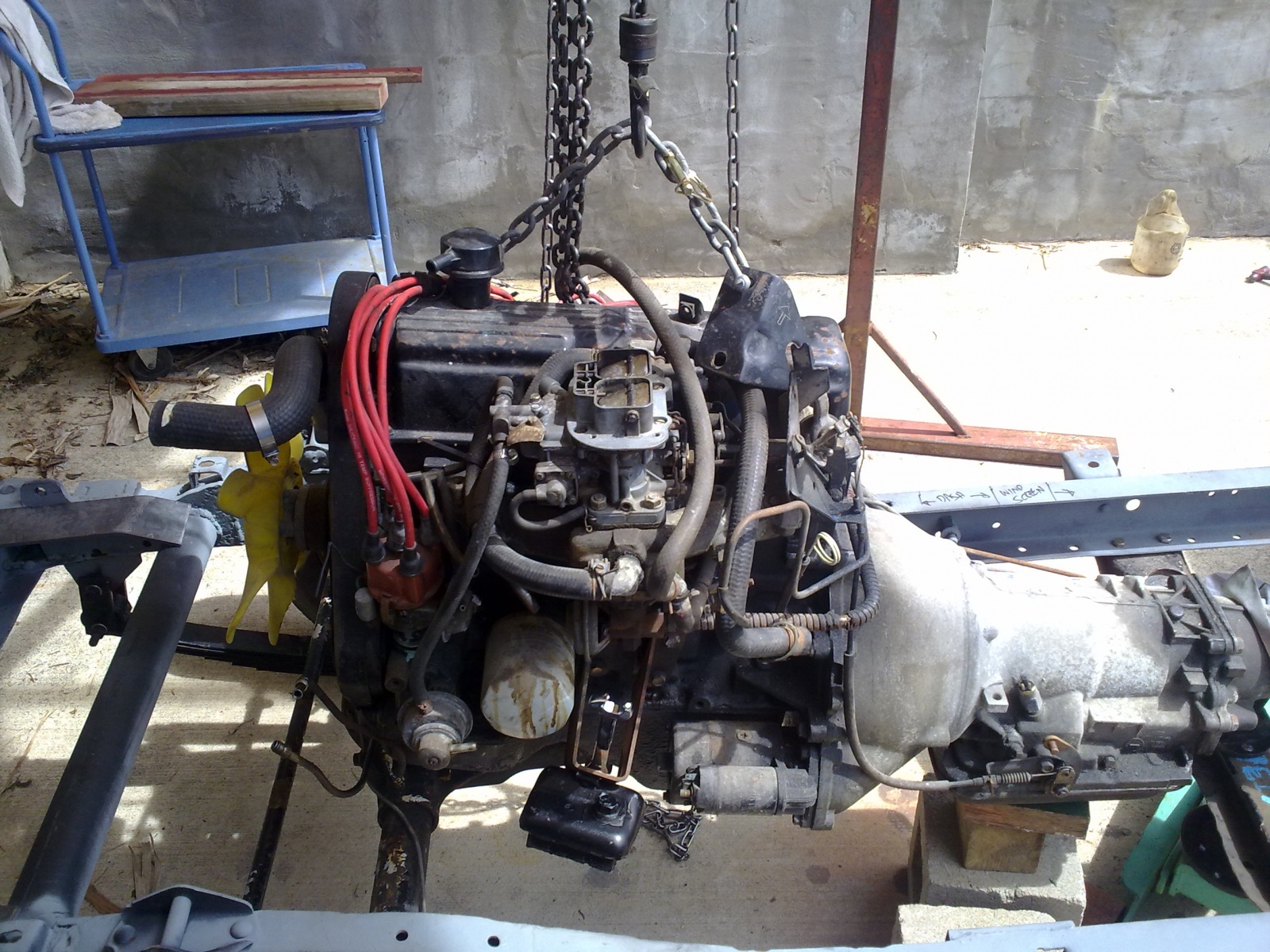

My CJ3B frame was a roller only as I did not want to buy a running jeep and use the frame only. I decided to fit a 2 Litre Ford Cortina/Pinto motor and Auto box. The diff on the 3B was offset so I had to put a 5B diff in it. These are only 4 inches off centre. My mate is a Hot Rodder and he made motor mounts to suit and motor sat 4 inches to the right

Motor mounts and transmission mounts were made and motor and box fitted
