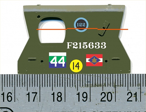

I've taken a measurement of the width of the kit part (cast mound including the weld bead), and then placed that over a scan of the glacis plate. Placing that unit of measure three times across the glacis, it ends up extending past the kit part.
Name:	T17E1_pic2 measure.jpg
Using the same method on an actual photo, the result is different. So wondering if maybe the kit part is tad large.
Anyone have access to official blueprints, or actual vehicle and provide a measurement of the width for the MG cast mound? The height measurement against the glacis plate would be good to have too if possible.

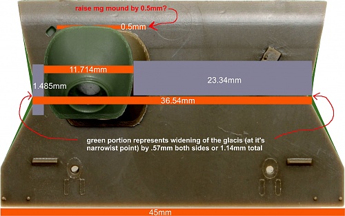

So here the computed results in image form:
Name:	adjusted measurements.jpg
Here we have markings in place - I see more space plus some breathing room finally on the bottom edge:
Name:	markings with dimensions adjust.jpg
My only concern now are how the rest of the glacis measures up on Bronco's kit. There was the widening at it's narrows point, but maybe the complete sides need to be widened by the same amount? Also the overall height of the glacis, but this can be difficult to measure since the top edge is curved.

Hello Marco, thanks once again for your help.
This second diagram you have posted is quite informative. The base width of the glacis at it's bottom edge has Bronco's kit only short by @ 0.65mm - I can live with that.
The other unit value of 245mm is interesting. That scaled down @ 1/35 is 7mm, while the Bronco measure is only about 5mm. This doesn't necessarily mean the kit part is short by 2mm, could be just the angled section above it is wrong or a combination there of.
Difficult to tell exactly because your drawing has been skewed in perspective, but it seems the mg mound is basically square shape at it's base- so it's height and width should be equal?
Only three more measurements and then, I think, this can be put to rest. Any values to input for below?

Marco, still more thanks to you for all your help. Here are the additional measurements in light blue bars;
Have raised slightly the mound and compressed it's height to reflect the new information. It's final height though is with a question mark.
Overall glacis height could have 0.5mm added but not really necessary - only if one wants a bit more space for the markings, in which case I would add that at the bottom edge.
The headlights are also very close, only 0.7mm off when measuring from their centers.
regards,
Jack
