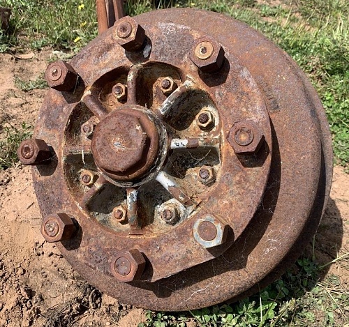

These are a couple of spare sets I got with my truck
D0217475-A41C-43EF-B379-63A6463E4D6F.jpeg   15736AB8-7919-4D51-B1B8-1D9BD124E364.jpeg   154A0A69-725A-45F5-B815-ED097A02F2DC.jpeg   88D91BC8-C896-4595-982B-F8417D94D11F.jpeg

Old 08-04-19, 00:46
Default Thanks for the photos.....
Nice to have spare parts to learn from.....
The first two pictures..... the ones with the small bolt holes.....are according to my reading....... the Heavy duty one and the small bolts hold a small domed hub cab/cover....... the lighter ball bearing variety has a screwed on sheet metal cap which is what I think I can see on your rolling chassis.
Looking forward for future posting of your project......

Old 08-04-19, 01:31
Join Date: Apr 2010
Posts: 1,068
In my experience the bearings used in the hubs shown in the upper three photos in Shaun's post 8 would not have been Timken Tapered Rollers but Hyatt Barrel Rollers.
These hub/drum assemblies were used on the heavy axle which would interchange as a unit with the lighter axle that used the cup/cone/ball arrangement fitted to most of the L/L trucks.
Strangely enough in post war Victoria (Aust) you were far more likely to find the heavy axle under a civilian 30 CWT truck than under an MCP which would have a civilian rating of 3 ton
I can only relate what I have seen over the years and the mixture of parts in these trucks has always been confusing.

Default Hyatt 11410Z and 11020Z barrel roller bearings...
You are correct David....... I would be happy to find the barrel roller bearing or the Timken rollers......... just hoping to find better than the ball bearing bicycle setup.
I tried to do a swap on a 46 to 1951 axle..... the Hyatt were bigger diameter and then center ID too big for the spindle........ HUB, Bearings, spindle must match............ still hunting for a larger HD axle.
Bob C.
