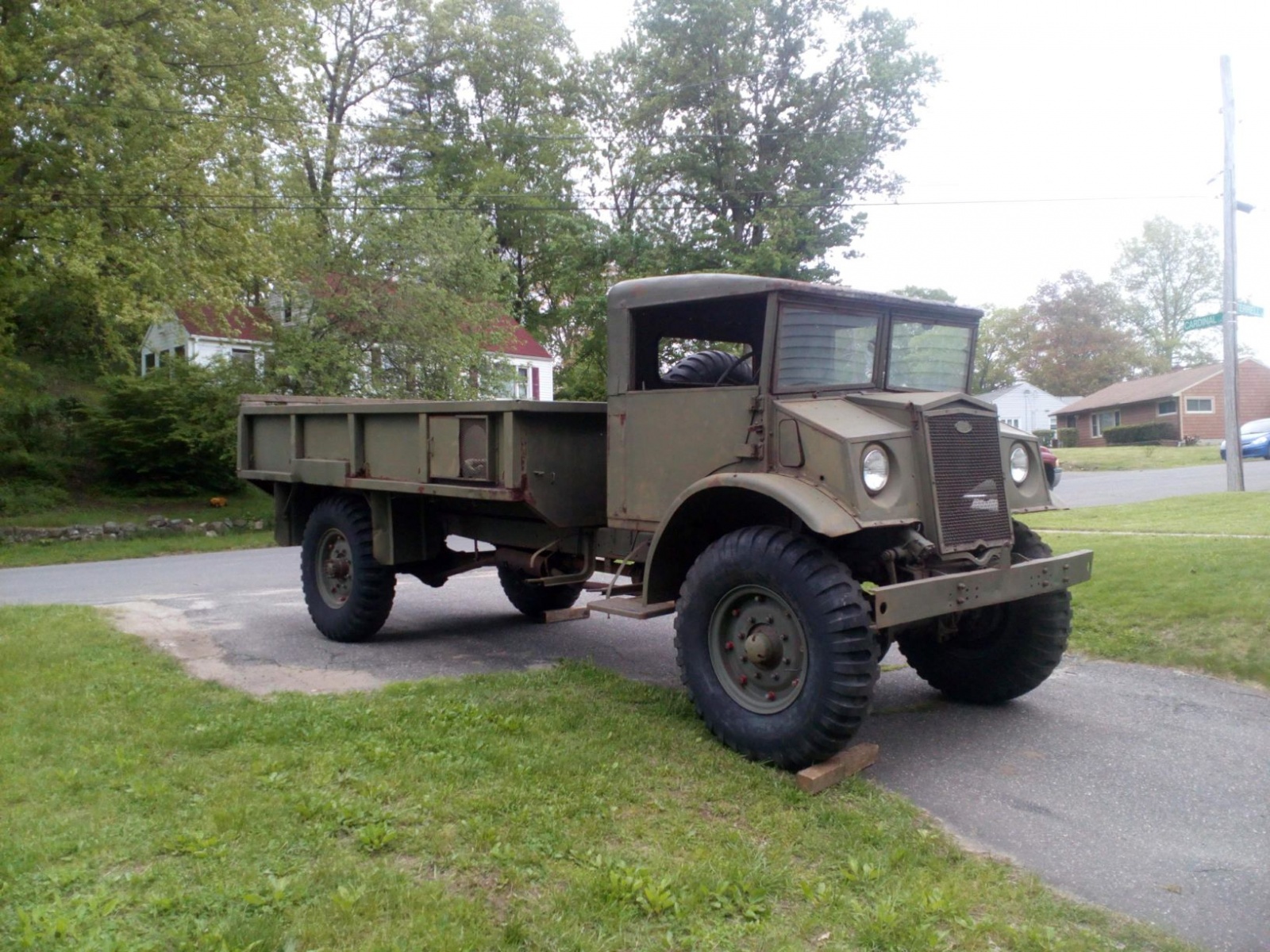

my recent purchase F60L. i have wanted a cmp for a long time and this kinda fell in my lap and it was a Ford, so i bought it. now most of you reading this that know my other projects tend to lean towards captured equipment reused by the german military. but breath a breath of relief i'm keeping this original Canadian military. overall this truck does not look to bad. some typical rust work and bed repair. but the drive line and axles and tires are in good shape. my short term goal is to get it to drive and stop enough to move it around the yard. and when i get a little farther on my carrier project then i'll put a long term plan together. but for now it's in my stable of Fords. so post some pictures and go from there.

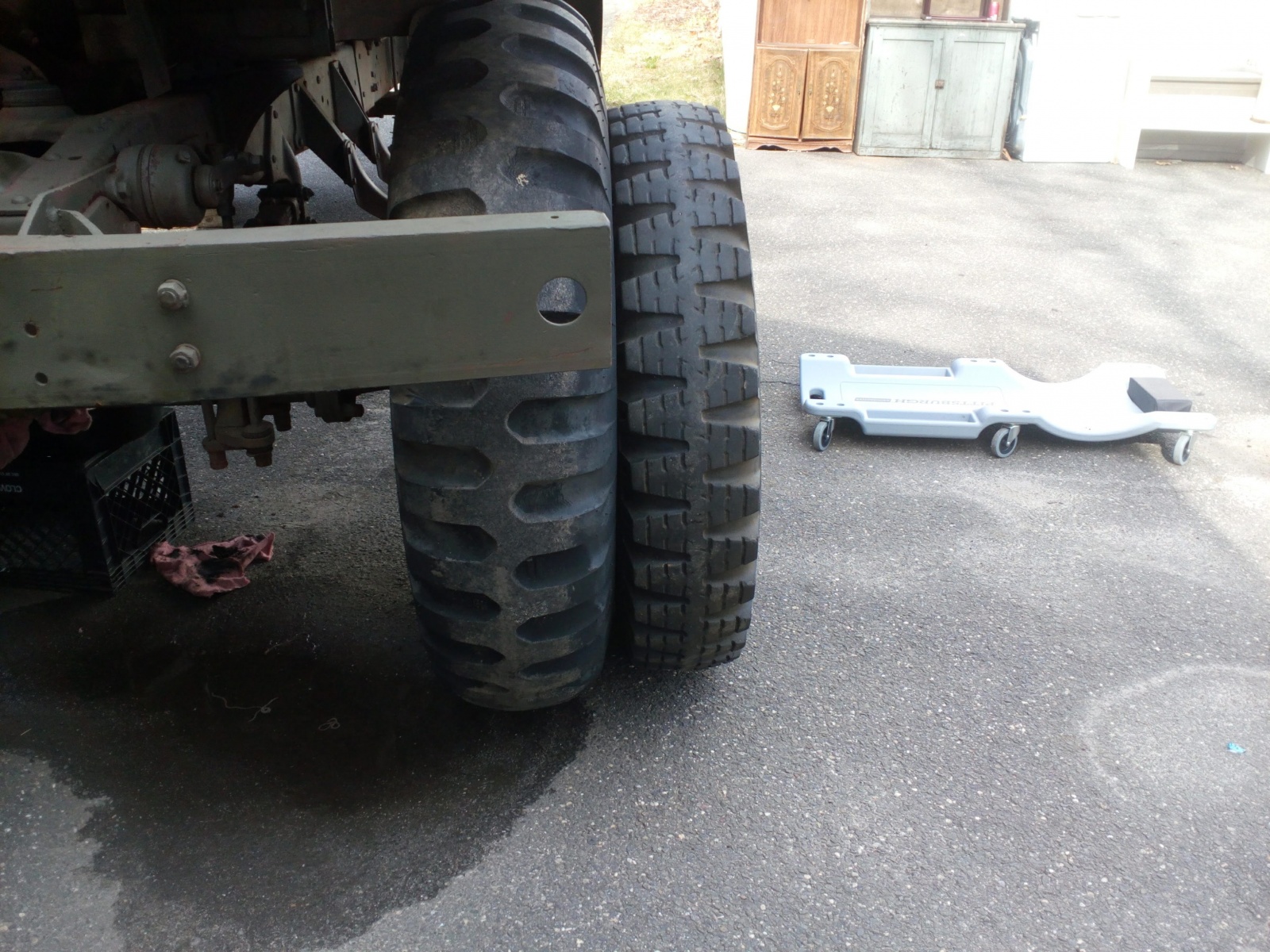

so i had to do some work on the f60l to be able to move it around. the brakes we stuck so i made a puller popped the drums off. the shoes and drums are in really good shape. i looks like some one was in these not that long ago so a little freshing up and it rolls quite easy. the engine is need of a valve job for sure. it did make some oil pressure when i was cranking it over so i'm hopeful the bottom end is ok. so i buttoned it up and it will have to wait it's turn to get done. it's like these 2 are old friends.

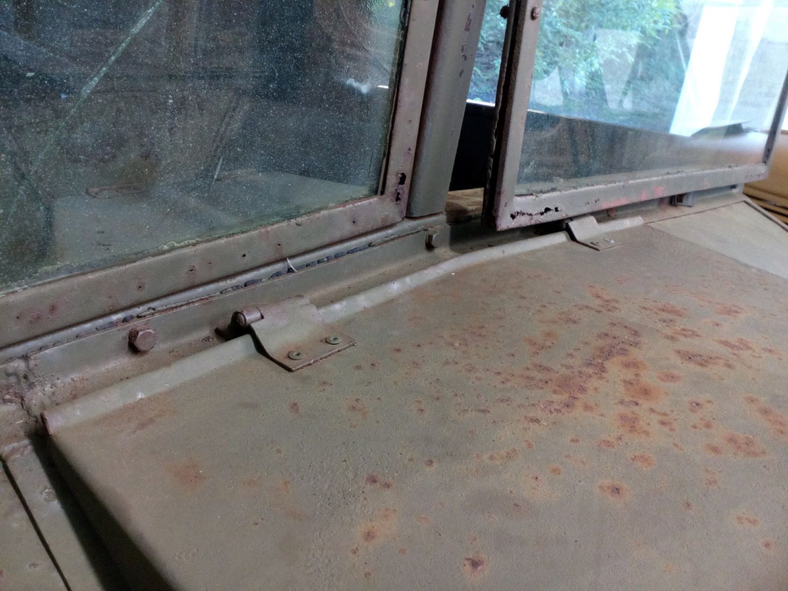

so i'm starting to find some clues as to what this truck might have been. the front bumper appears to be original. and the bed has a tag still attached so i hoping to find out what it original purpose was. the cab has some of the interior left. there's a tag on the engine cover that states something about winch operation but i don't believe this truck ever had a winch on it. the cover and dash are grey so i pretty sure their not original to this truck. the 11.00x20 make my 7.50x20 look really small. and my helper in his glory. so i've put it in storage for a bit.

Nice looking CMP. Also nice the body data plate has survived. The 5D4 is the Body Code Number. ‘5’ denotes the vehicle wheelbase size the body is intended for. In this case 158 inch, either Ford or Chevrolet. ‘D’ would be the type of body. In this case it looks very much to be a standard General Service (GS), or Cargo Body. The ’4’ denotes the fourth variation of this type. The serial number is directly across from the Body Code Number. There were a lot of body manufacturers during the war. The serial number indicates production from Brantford Coach for this body type only.
Top dead centre on the data plate is the Canadian Military C-Broad Arrow Acceptance Stamp and the three digit number to the left of it is possibly the Inspector’s Stamp Number.
The Ford Data Plates were frequently mounted along the top inside vertical face of the driver’s door, but not always.

"5D4" according to Servicepub's book would make it a Workshop version of the 5D1 GS body. Do I spot a little door in the left side front of the body?
It seems it might have had a taller radiator fitted at some stage(?) as the engine cover has been reshaped to a higher peak than standard.

yes it does have a small sliding door on the drivers side of the bed. interesting about the hood. it did come with a radiator that looks original and does not stick up higher than the hood. but who knows what might have been fitted in it's past life. the hood does fit the sheet metal behind the grill pretty well.

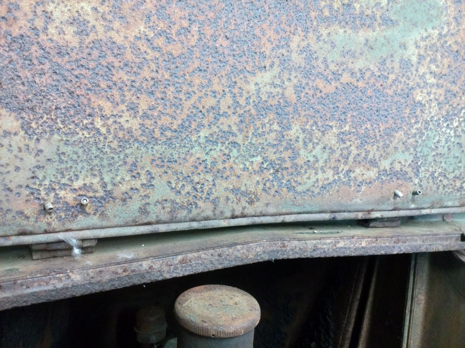

the hood was most definitely modified to fit a taller radiator. i believe it's the original hood just stretched and welded. it will be an easy fix to bring it back to shape.

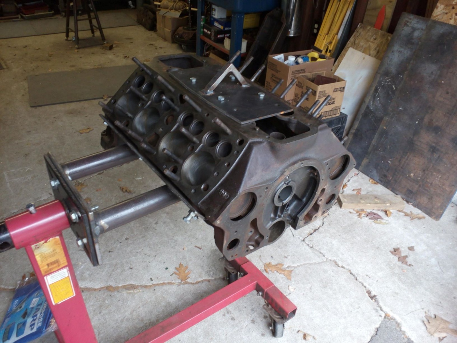

so when covid hit back in May my blaster closed up and it stopped work on my carrier. so i turned my attention to the cmp. i had pulled the engine around the same time i was hoping to be able to do a freshen up to the engine put it back in and drive it around the yard. once i really got into it the engine needed a major rebuild. and when i looked harder at the transmission and transfer case they both needed attention. top it all off someone tried to retro fit a newer? master cylinder to it. so it made sence to strip it. i do have the radiator shrouds but no cross bar. and i have a manual for it. there's no doubt i'm missing a fair amount for parts for it. and there's absolutely nothing around here for it. so i might be taking a trip north to do some shopping.

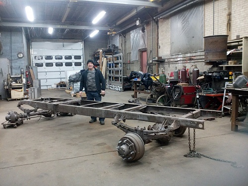

the engine is off to the machine shop. had some water damage in two of the cylinders. and it for sure needs a valve job. it's an original 99 block. i'm missing the water pumps for it. got the bed off. and rolled the chassis into the garage. i built a temporary wall so i can heat the garage and work with out gloves. so i'm just about done removing all the drive line items. when i'm done with the front half i'll spin it around and do the back half. although there's not much to do.

i found my frame serial number. it's messy, typical Ford. lol. the transmission number doesn't match the frame. not surprised. and it appears that i'm missing my poppet vale for the brakes. luckily the mechanism for the master cylinder and frame bracket are there. it looks as though i could operate the brakes with out it although i'm sure it needs it with these size tires.

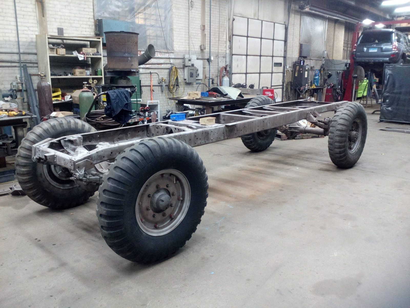

some more progress. sand blasted the frame and a bunch of small parts. made some collars to protect the tires from the blasting and paint. Click image for larger version

i struggled with the paint. the color seems to elusive. of course i looked here and in some publications. but matching the paint was difficult. the computer eye that matches the paint was putting to much brown. so i ended up using RAL 7008. seemed to be a really close match. and i can get it mixed to match in the future real easy.
