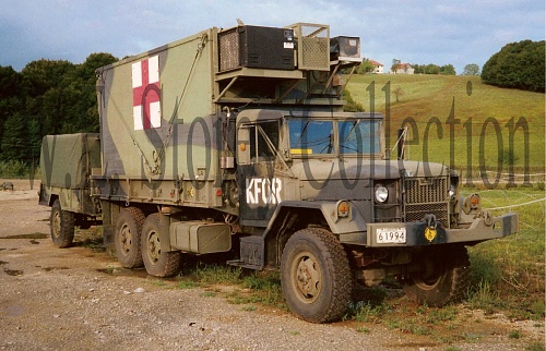

According to C-30-352-000 MA-000 Data Summary - Truck, 2½ Ton, MLVW, M30 CDN Series Cargo Model M36 CDN - 1985 the purpose of the M36 Truck was to transport, special, extra long, removable shelters and stores. It was supplied both with and without a winch.
This photograph I took in Bosnia of a M36 Dental Van nearly two decades ago is a good example of the type in use by the CF.

Thank you very much for the picture. I recently seen some of the longer shelters for sale and didn't make the connection at the time.
