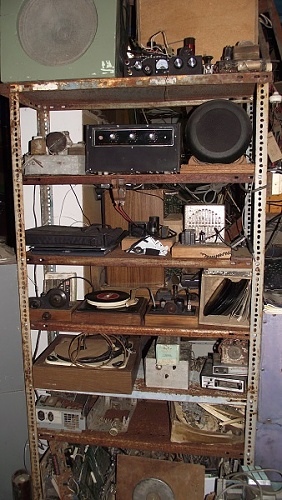

Over the Christmas week I tidied another section of my radio shed, assembled a set of shelves and got some of my home-brews out of storage, then after checking them for working condition, I displayed them on the shelves

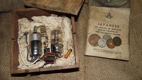

Dad and the yank returned to the cave and stripped meters, knobs, valves, little dynos, and parts from the radios, eventually Dad sent a wooden box (24”x 18”x16”) full back to home.
While he was on Borneo a POW from either Sandakan or Ranau, approached him and asked “Are you the radio man?”
Dad affirmed, The POW handed him a little box “You might find a use for this, We don't need it any-more”
Dad and I had examined the valves inside, they were 1R5 Gt, with the bases removed
The valves and wiring look impressive, however it will not do anything,
Firstly the plate (?) of each valve is connected to the Grid (?) of each valve
and secondly - one filament is open circuit!
What was it's purpose?
We all can only surmise, perhaps, to surrender when the Japs threatened heads would roll, if the camp's radio was not forthcoming.
The valves in a little wooden box has always intrigued me

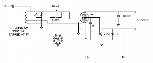

I changed the layout, compared to others on the internet, to make the wiring as direct as possible.
As the original was supposedly left behind, we don't actually know it's layout anyway.

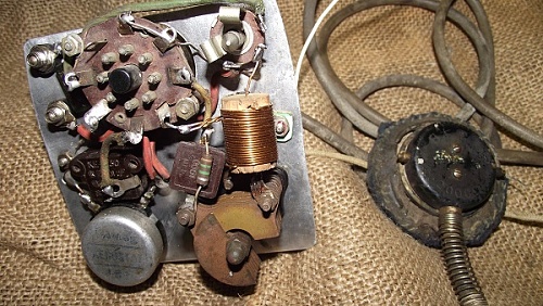

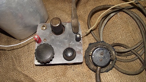

The construction took me a couple of days, from finding parts and cleaning them to the metal work
Deciding on the layout took some thought and time, my canteen is a 1 litre as opposed to the original, possibly being a quart, so I had less area to use
I had some of the Japanese capacitors and a single headphone, so I thought in keeping with a POW radio I would use them
I wound the coil on a cork
I used rubber and cloth covered wires
Does it work?
Well maybe I should not have used the Jap caps as the radio stations are in a foreign language LOL
The reception is quite loud and stable (I have a single wire about 100 feet long and 30 feet up)
It will even work (weak) on the 12 volt for the HT, but requires very delicate adjustment of the re-gen control
