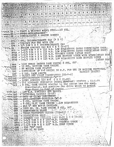

GAU is the Ford model designation for the T16 Universal Carrier. The Ford list of designations for government models goes attached. GPA, GPW, G8T and GTB may be better known, and GAU is on that list as well. Did you know GAE was their designation for the conversion of the 90 hp V8 enigne for use in British Universal Carrier?
Attachment 112442
That is a really interesting document Hanno, I will have to cross check it with my Loyd engine part number table.
