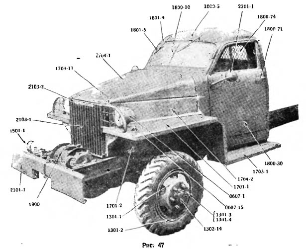

Old 12-04-20, 00:56
Join Date: Feb 2016
Location: Bulgaria
Posts: 95
Originally Posted by David Doyle View Post
I am curious what the early manual shows as the part number for the radiator guard (group 2103).
Any help appreciated.
Hi David,
Have here a really bad but still readable picture from the spare parts catalog for Russia. It was published in 1943 but IMHO the picture is from earlier catalogs not after 1941, if judging from the symmetrical headlight guards and item 2103-2.
And the same picture with much better quality from the spare parts catalog for Britain, also published in 1943. The nameplate is there but the item No. is deleted. Probably the one who was responsible for the pre-print preparing decided the arrow is too hard to erase.
I wasn't able to find the number 651031P in those references I have here. I've found only 649305P but apparently it is out of question, being retrieved from late catalog. Where 651031P is, Darryl? TIA!
Cheers!
