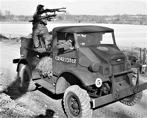

In 1994 Brian , Les and I went to Portsmouth on our way to Normandy for the 50th. A gentleman there graciously let me spend about two hours in the back of his truck carefully getting detailed measurements and photos of his Motley Mount that came from Portugal. He said they were made in Canada but there was no identifier on it. I probably drove Les and Brian crazy going back all the time to check this thing out. I made two copies of it with the only difference being they were the mature model with the main pipe frame being a little longer for the tummy. It was just too cramped. The one in the photo with my daughter Dawn is the prototype and you can see the main pipe was made in sections to try and get the angles right. The second one was all one piece.
Dawn's picture is in the back of Mel Norwick's 8cwt and I think Hanno has a better photo of that truck. I need some ideas of what I could use for a rubber eye piece.

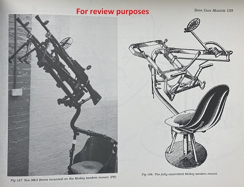

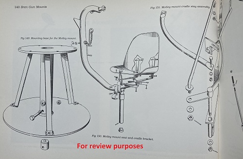

I made photos of the pages on "The Mounted Bren" from The Bren Gun Saga by Dugelby for research purposes.
No mention is made of the manufacturing of these in Canada. Despite the fact that this book is highly sought after (wow!), the information in this chapter certainly doesn't seem to be the final say on this topic. It doesn't differentiate very well between the various types of mounts that were made. Here's hoping someone can add to this.
Name:	Dugelby p.138.jpg
ID:	115646 Click image for larger version
Name:	Dugelby p.139.jpg
ID:	115647 Click image for larger version
Name:	Dugelby p.140.jpg
ID:	115648 Click image for larger version
Name:	Dugelby p.140-141.jpg
ID:	115649 Click image for larger version
Name:	Dugelby p.141.jpg

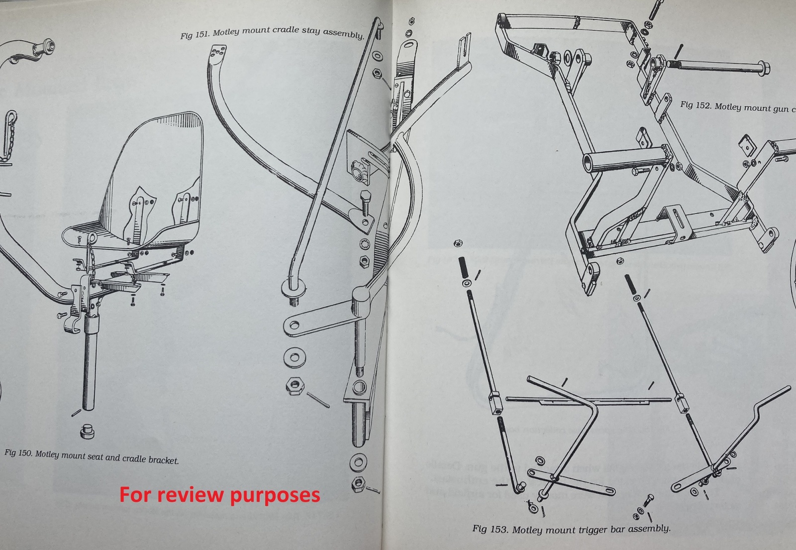

Last two pages on Motley mounts:
Name:	Dugelby p.142.jpg
ID:	115651 Click image for larger version
Name:	Dugelby p.143.jpg

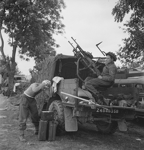

Default Motley mount on Dutch Prinses Irene Brigade truck
In an earlier thread I posted a picture of a Motley mount in the back of a Dutch Army Ford WOT2 truck in Normandy, August 1944.
The scan in the archive has been updated and you can now zoom in on the picture for some great detail - click on the source link:
Beschrijving: Koninklijke Nederlandse Brigade Prinses Irene.
Landing in Normandië [luchtafweergeschut gemonteerd op een vrachtwagen. Een soldaat wast zijn haren]
Datum augustus 1944
Locatie Frankrijk, Normandië
Nummer toegang 2.24.01.03
Bestanddeelnummer 934-9669
Source: http://proxy.handle.net/10648/ad84e3...8-003048976d84
