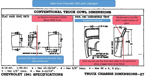

I've been researching these trucks for about 5 years now, collecting information from various sources including here. Its more historical and modelling than mechanical so bear that in mind please!
The Chevrolet 1533X2 30cwt LRDG truck had a flat face cowl on which a straight dashboard was fixed. This has been an area of contention for a few years, and having spent some time researching the details I am as confident as I can be of it's accuracy. The drawing is mine and not to scale. I don't have a truck on my drive to get measurements, so it's the best I can do and shows a general arrangement of the dashboard. There are 2 features I am not sure of on the dash board and any help identifying them would be great. I have included a diagram of a standard dash for comparative purposes and to confirm item identities. There are only partial views of the dash board that I have or know of in existence. The CMP grab handle wasn't commonly fitted, or, as it can be folded, maybe more common on the trucks but not visible behind the folded canvas door. The stencilling on the glove box maybe instructions for the PTO driven air compressor, or maybe some other factory applied Chevrolet information/data. Any information on the contents of the data decal would be great. Does anyone know whether the temperature gauge would be supplied by Canada to British forces in Centigrade or Fahrenheit?
This information comes from a company that does re-production gauge faces online, Maple Leaf Up Forum and various other sites including the LRDGPS forum.
ID:	117146 Click image for larger version

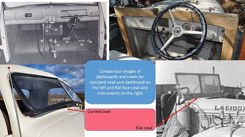

When I first started looking for information on Chevrolet trucks, I read posts discussing various aspects. One thing that I found confusing was the term flat faced cowl on the trucks, normally from those who are trying to, or have built a replica. I eventually worked it out by myself, but thought a quick post might help those not sure of it either.
The standard cowl was designed to incorporate an angled 2 piece hinged windscreen to be fitted to the hard top cab. this meant the dashboard and the bonnet (hood) was shaped in a shallow v to accommodate this. It also meant that the dash had a different rounded civilian profile to it with a specific instrument cluster.
The LRDG didn't need the cab and the standard Chevrolet model for this was a flat face cowl, which was flat vertically at the door pillar and across the dash. This allowed it to have a straight 'Jeep' style folding windscreen which was a standard fit on the LRDG batch. (These windscreens were frequently removed and replaced with Aero screens, but you often see the original jeep windscreen mounts on the front edges of the wooden dash surround.) This cowl also had a specific set of instruments. The following annotated drawings are from the 1941 Chevrolet catalogue, and photos from Maple Leaf up Forum and various internet sites I no longer remember!
ID:	117151 Click image for larger version
ID:	117152 Click image for larger version

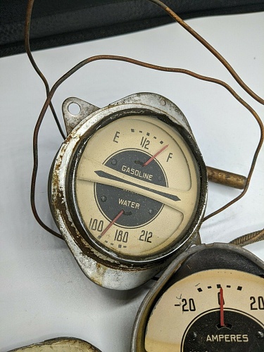

While we're Ebaying, here's a collection of all the gauges:
https://www.ebay.com/itm/1937-38-OEM....c100005.m1851
Odd that the Temp gauge stops at 212 F. Don't Chevs boil in the Desert?
Name:	LRDG gauge 2.jpg
ID:	117195 Click image for larger version
Name:	LRDG gauge 1.jpg
Name:	LRDG gauge 3.jpg
ID:	117196 Click image for larger version
Name:	LRDG gauge 4.jpg
Old 01-11-20, 04:31
Posts: 2,323
It sounds like the gauge was designed for a non-pressurized cooling system that used plain water as the coolant. That system woild boil at 212 or less, depending how high an altitude you are at. In such a system, if you saw the gauge approach 212 you would know that you were getting close to boil-over and should take immediate actions to avoid losing your water (in a desert where it might not be easy to replace.....)
Old 01-11-20, 09:12
Posts: 3,678
Aren’t most automotive gauges serving this function marked ‘TEMP’? I cannot recall ever seeing an automotive gauge set up like this before. As Grant suggests, it certainly draws ones attention to the importance of the commodity in a desert environment.

Major Ralph Bagnold, pre-war desert explorer and creator of the LRDG, used condenser cans on the side of the truck to recycle steam/ boiling water. Copied on SAS jeeps and incorporated into later designs of military and postwar civilian vehicles.
Lovely photos of the gauges, thank you for posting them.

Hi Philippe, Your truck doesn't have a Flat face Cowl. It has a cab with a split window windscreen which is angled, not flat. The FFC was designed so that buyers could fit their own cab, or not. The front frame of the door is angled forward, whereas a FFC would be vertical. Hope that helps.

As can be seen in the Chevrolet catalogue “Flat face” means the vertical part of the cowl is flat with A-pillars being perpendicular to the chassis. This gave body builders all the freedom they needed to build bespoke cabs and bodies. So it doesn’t refer to the cowl vent area to be flat (alone).
So the buyer ordered a chassis/cowl and then contracted a body builder. Especially in Asia even today truck builders still make chassis/cowls, for outside contractors to build a body.
