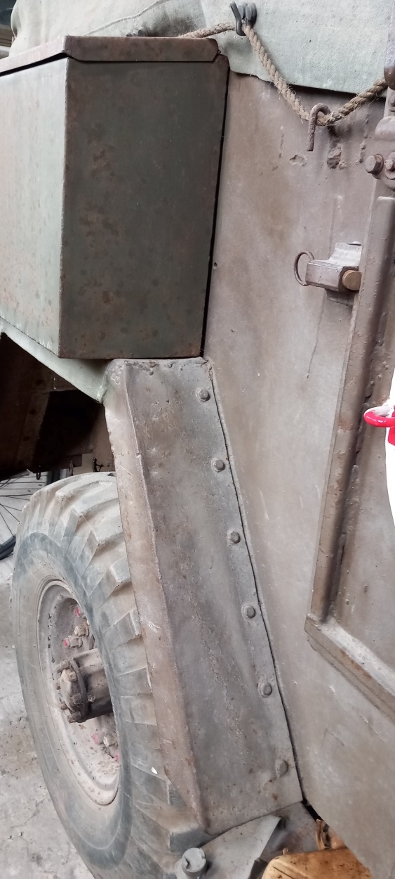

This is Preston Isaac's C15TA, one of the examples which did not have rear side bins originally. Preston added them when he did a quick restoration for filming “The Wall”.
Those rear fenders do look different though.....not the "fancy" angled fenders like on yours, but more simplified. Oddly enough they look similar to the ones on the Ambulance C15TA (with dinosaur step) that Barry posted!
Old 05-11-24, 15:38
Default same same
That's because it is the one and the same - the mudguards were bashed in and are now (somewhat) restored.
Name:	Preston C15TA rear mudguard.jpg
Old 05-11-24, 19:02
Yes......I knew that....
The black and white picture completely fooled me!
Still, the fenders look different.....like someone trimmed the sides.

Here is a better view of the two rear chore horses.
Barry
