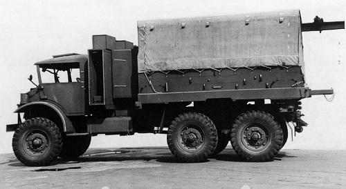

Old 09-08-20, 12:06
Posts: 14,970
The link is dead, text copied here, pics may follow later?
"Nomenclature | Total Number | Service Arm
Truck, 3 ton Breakdown (Aust) No.4 | 120 | Army"
Pic courtesy of Keith Webb
