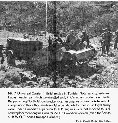

Default Mk.I* Universal Carrier with Ben Hur trailer
Just came across this photo in an old thread. An unlikely combination!
Originally Posted by cletrac (RIP) View Post
The second picture is a Canadian produced Carrier in Tunisia from Gregg's Blueprint for Victory.
Name:	04b Carrier Mk1.jpg
