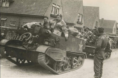

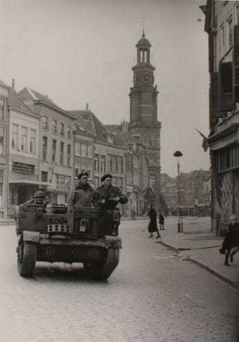

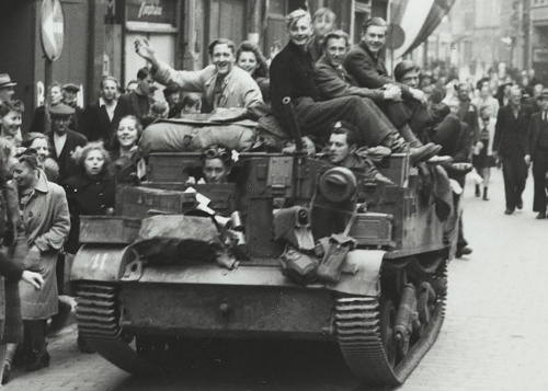

The subject is a 8 "barrel" Smoke projector that can be seen in some 1945 pictures of Canadian Shermans, and also Wasp carriers.
I don't even know what the proper name is for this piece of kit....but after speaking with Tim and Hanno, we thought at least it deserves a thread of it's own to gather info and learn more about it.
According to a quote from a war diary posted by Steve Guthrie on another forum, the projector was developed by the RCEME.
Attached are some period pictures of Wasps showing the projector, as well as a Sherman Firefly Ic with the projector fitted to the mantlet.
1st picture; Wasps in Beilen 1945, source: https://beeldbankwo2.nl
2nd and 3rd picture; Wasps in Zutphen 1945, source: https://erfgoedcentrumzutphen.nl
4th picture: Wasp in Zwolle 1945; source: https://historischcentrumoverijssel.nl/
5th picture; Sherman Ic; source: https://www.canadiansoldiers.com/veh...hermantank.htm

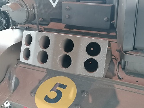

The Dutch Army museum has a Wasp carrier in their collection. After spending years in depots away from view, it's currently on display for the general public in the NMM, the National Army myseum in Soesterberg. It seems it was repainted recently, but more important.....it is still fitted with the smoke projector.
pictures taken last saterday.

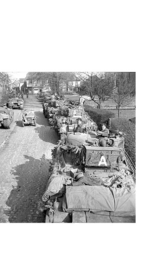

Old 14-09-21, 23:01

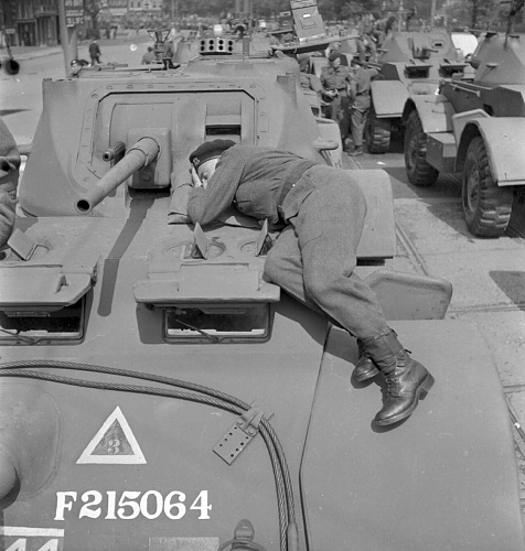

Attached is a picture of a row is Staghounds, waiting for the parade in Amsterdam, may 1945. A smoke projector can be seen in the distance; were they also fitted to some Staghounds (Marco??)....or could it be a different vehicle?

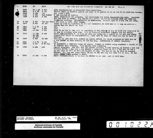

This started for me about a month ago with the photo of the Governor General Foot Guards Sherman Firefly in Germany 45 and the obvious "what's that on the Mantlet" question.
Digging on the Canadian Military Model Maker's forum on Facebook led to the info from Steve Guthrie and I have since found relevant pages in the 4th Canadian Armoured Brigade war diary for the demo to units.
Name:	oocihm.lac_reel_t10659_data_sip_data_files_1029 - SMOKE KIT - 11JAN45.jpg
Name:	oocihm.lac_reel_t10659_data_sip_data_files_1035 - SMOKE KIT - 12JAN45.jpg
Name:	oocihm.lac_reel_t10659_data_sip_data_files_1038 - SMOKE KIT - 13JAN45.jpg
Name:	oocihm.lac_reel_t10659_data_sip_data_files_1050 - SMOKE KIT - 15JAN45.jpg
In addition to the war diary data, I have found some other photos of GGFG Sherman with this mounted on the Mantlet which I will find and post.
Also, I am advised that the Ferret Armoured Car had a 66mm Launcher which used the F013 electric fuse (very similar to the No 14 electric fuse) which also launched the no80 smoke grenade.

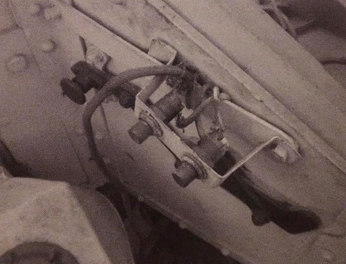

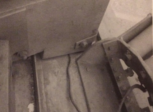

Old 16-09-21, 03:09
Posts: 4,191
Pictures from Nigel Watson Universal Carrier Vol2 book. The carrier is the Wasp mk2 that Alex photographed.
This is the push button switch for the launcher.
Same push buttons as the unit for the rear smoke generator (No8) for the Sherman (On that the buttons are in a box with the convoy light switch above the driver's dash board).
Tim
For the sake of completeness of this very interesing and thorough topic, here's the war diary entry Steve Guthrie dug up:

Colin, Jordan, thanks for the terrific additions!
Here is another Wasp during a liberation parade in Utrecht 1945.
source:https://hetutrechtsarchief.nl/
