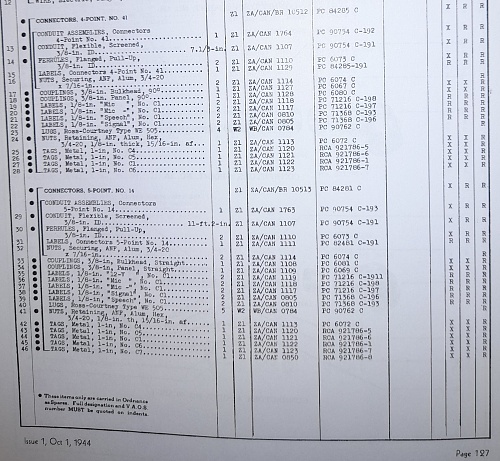

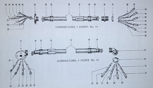

Do you have the ZA numbers?
Jordan
Connectors 4 Point No 41 - ZA/CAN/BR/10512
Connectors 5 Point No 14 - ZA/CAN/BR/10513

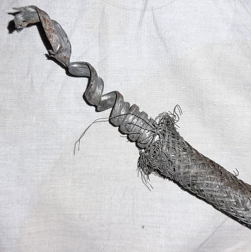

I think the 'screened conduit' was standard flexible conduit for the period with a braid screen added (and U-section terminations soldered on to keep everything connected together). Any screwed collars would be added before the final termination was soldered on, and they would match the threads on the industrial electrical fittings of the period.

I suspect the solution will be to get both the braided sheath and the flex-conduit and make some, especially given the lengths.

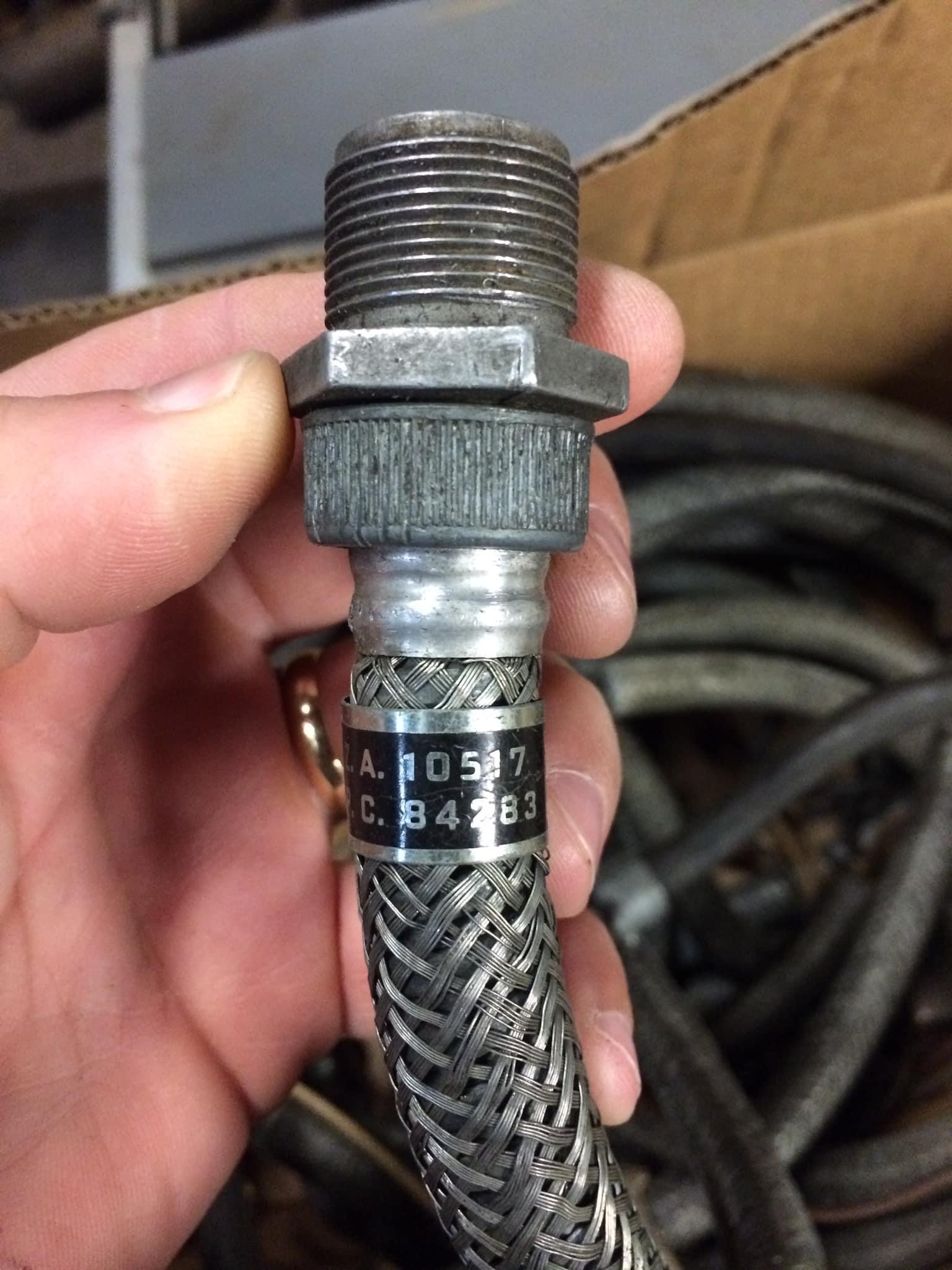

I checked and don’t have those part numbers. I do have these ones though. I’m not sure if the elbows and other threaded connectors are what you are looking for or not.

According to "Radio Stations, British No.19 Mk II (USA), Consolidated Installation Kit Register, July 4 1944":
PC 82480/ZA 10304 - Connectors 3 point, 1/2" x 22" No. 12 (6 pin socket/lugs) is used on Staghound.
PC 82483/ZA 10517 - Connectors Twin, 1/2" x 44" No. 121 (6 pin socket/lugs) is used on Stuart III (M3A1) and Locust.
SD III - R56-A - Connectors 4 point, 1/2" x 24" No. 40 (6 pin socket/lugs) is used on 75mm and 105mm Shermans and M10 17 Pounder.
