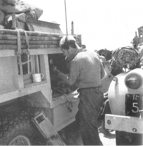

I recently got sent a photo of a Y Patrol Wireless truck in connection with something unrelated (apologies the photo is from a private collection and I can’t post it).
The photo showed a wireless operator sending/receiving a signal on his No11 set. What struck me was that the other truck (Chevrolet 1533X2) was parked so close to the wireless truck. It reminded me of another well-known photo of an identical arrangement (attached). The trucks only just allow the operator to fold down his work shelf and stand in front of it with his back to the other fender. The trucks are aligned so that the driver’s seats are as close as possible to each other. It’s a very cramped set up considering they have hundreds of miles of empty desert to park in, and that they should be dispersed for camouflage, and so they present a minimal target should they be spotted by aircraft, as seen in most photos of a Patrol laying up for the night
So it strikes me that there had to be a reason for it. It is too deliberate and precise to be chance.
In front of the driver’s seat on the floor panel is a battery inspection hatch. The arrangement reminds me of how you would place 2 vehicles to jump start one of them. So is this a Wireless power issue, or a wireless causing flat batteries and the other truck is on standby to jump start it? Would the use of the Wireless cause the battery to loose so much charge that it would need jump starting? If so what is the point of the spare battery on the side step of a wireless truck? Or is it for some completely different reason?
My knowledge of WW2 Radios is limited so hopefully someone with greater knowledge/experience can chip in.
Something else I noticed that I didn't expect is that the aerial is connected to the wireless only when the wireless is in operation and is plugged into the front of the wireless and out the front of the wireless compartment. I have always assumed the aerial and cables were 'properly' wired into the body, through various holes in panels and eventually the wireless. This set up means that the Patrol couldn't send/receive messages when on the move (ignoring the issue of connecting headphones into the wireless at the same time!).

Feel free to tell me I'm wrong - I don't claim to be a wireless expert.
I have the impression that the WS19 required 12V (or 24V) to operate. Most trucks of that era were 6V. Is it possible that to avoid carrying both wireless batteries and charging sets (on trucks that were already heavily loaded) they devised a scheme to connect the batteries of two trucks in series to give 12V?

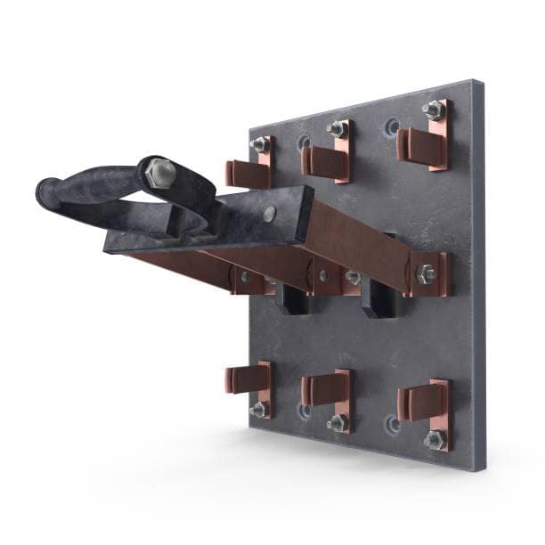

The panel has at least one knife switch and I assume based on other charging panels it would need 3-4 to make it work (see attached MKV Panel).
Hanno has suggested that the panel could be a main on off switch and posted the image attached. It doesn't match the original photo but has opened up more questions about the set up.

My guess on the knife switch, Charlie, is that it is the selector switch between two distinct aerial setups for the wireless set so the operator can change quickly from one operating frequency to another.

In the photo from Charlie it shows a 4pdt switch on the side of the vehicle. It's in a convenient place on the side where batteries would be kept. My thoughts are this is for charging batteries. Here are some diagrams of the battery system from my M152 sigs van. You can see there is a 4pdt switch to select battery banks and each bank has a pair of wires connecting to the switch. This allows one set to be used and the other to be charged. The knife switch is not rated for radio frequencies so you wouldn't want to attenuate the already low power output.

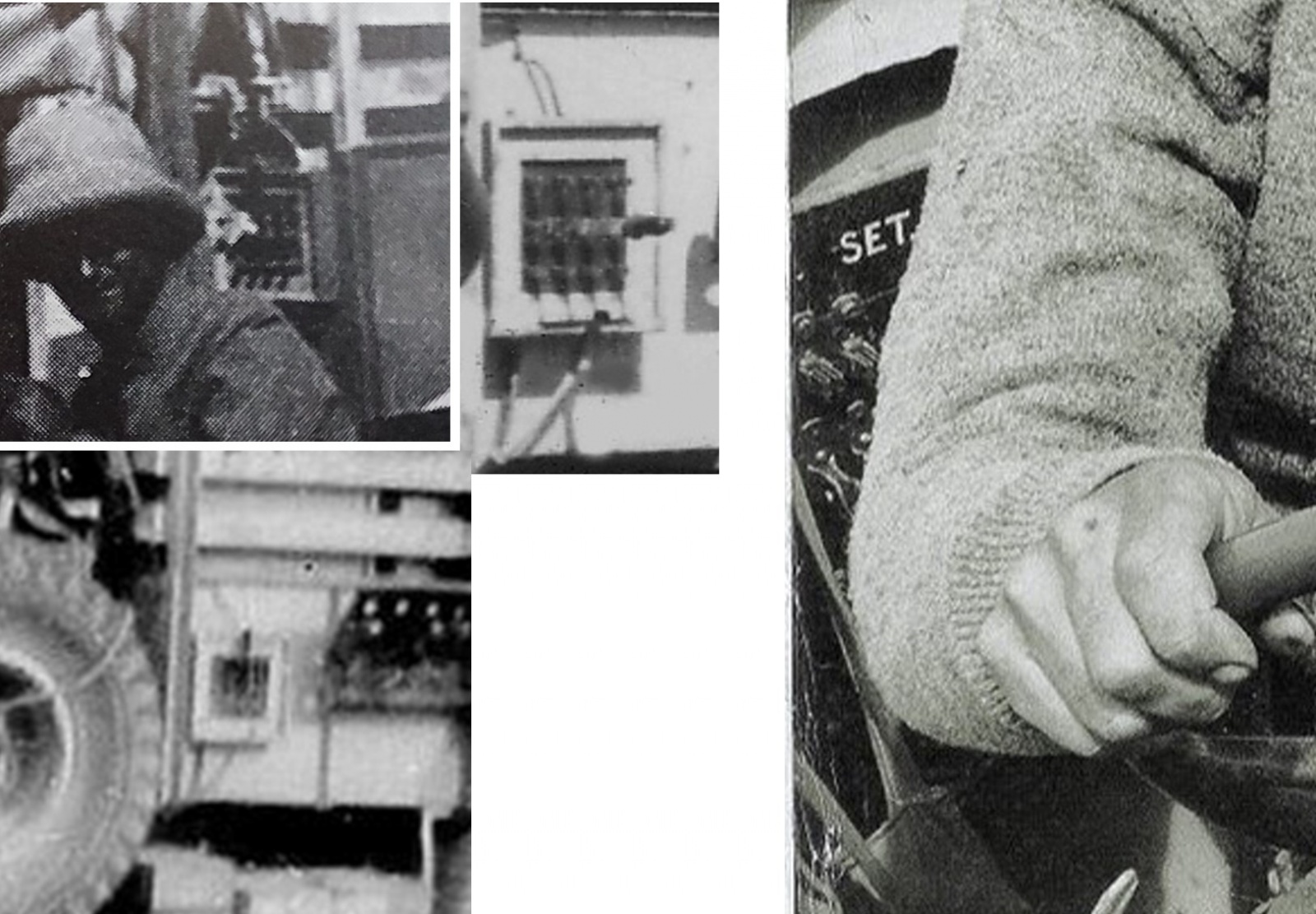

The photo suggests to me that there was one large knife switch and 3 other smaller (knife?) switches, as opposed to 4 ganged together. however I understand the concept of the ganged 4 switches, just trying to work out how that idea could be accommodated by the truck 's wireless set up.

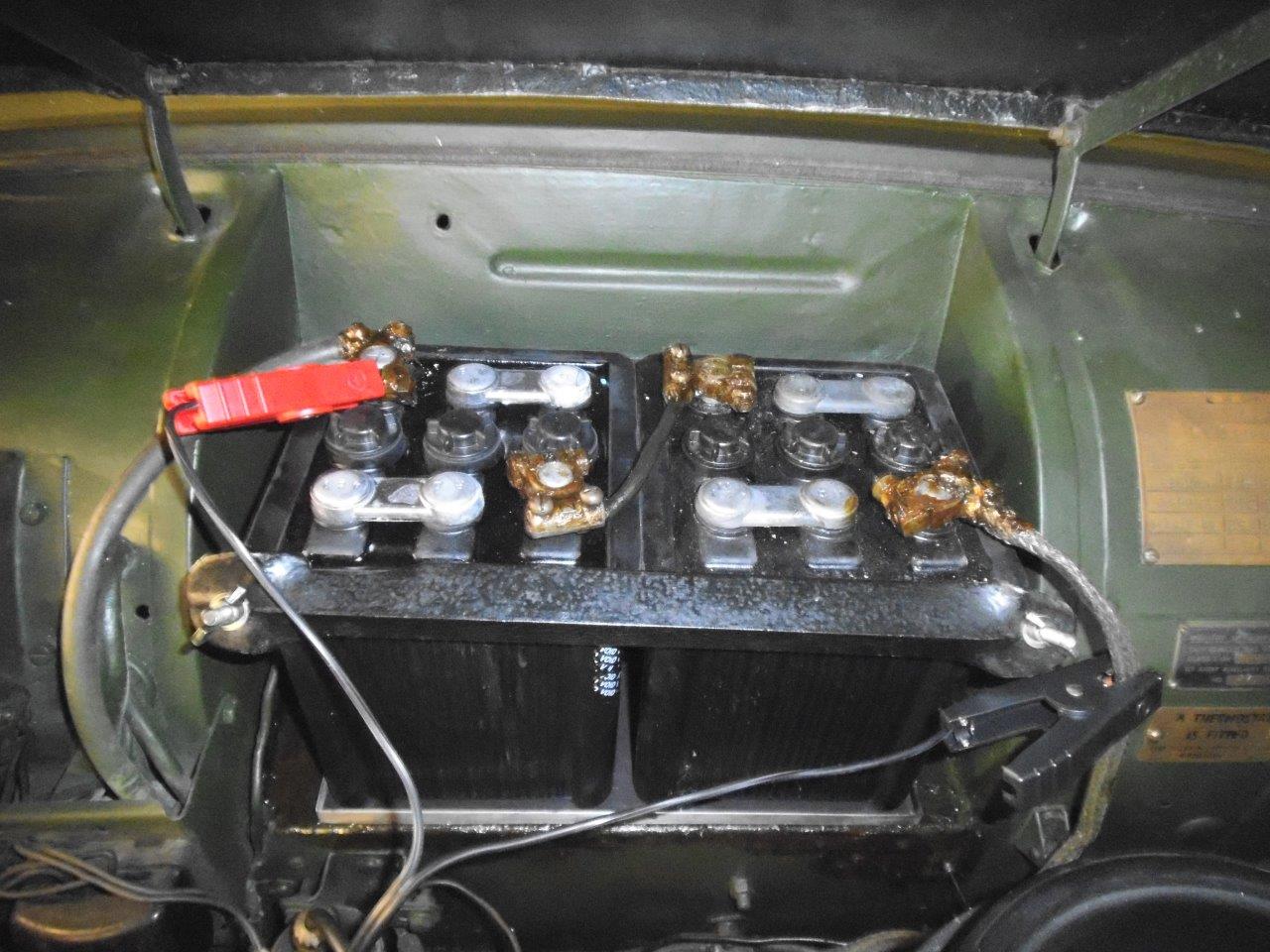

Attached is the best view of the wireless battery on the sidestep. I don't know if that helps in any way. 12 Volt maybe?

As far as I'm aware, only the top view of the battery will tell you the voltage (by the number of cells visible).

So does that mean the panel only needed one knife switch, and they used a standard 4 switch panel and removed the other 3 knife switches, or a 2 knife switch panel with a knife switch removed? The 2 positions of the switch would be series and parallel.
Looking at the attached compilation of switch panels I think I'm leaning towards a 2 switch panel with one switch removed.

So, having thought about it and looked at other documents and photos, my current conclusion is that the LRDG used the same set up throughout the Desert campaign on all their trucks-Chevrolet WA, 1533X2 and Ford F30s. They used a WS11 High Power unit with Windom centre feed or sometimes end feed aerials on 16' duraluminium poles stowed on the trucks, and the 4' rod aerials for local (100 mile range) communication between Patrols. The power supply was fed through a 'Special' series/parallel switch for trickle charging/wireless use, from 2 standard 6 Volt batteries, one the truck battery, the other a 'booster' battery to provide the necessary 12 volts with the truck battery for the wireless. The 'booster' was mounted on the side step in front of the driver. During long periods of stationary Patrol, Road Watch, the Patrol would either take a chore horse to recharge the batteries or swap batteries with the other trucks in the Patrol. Very high levels of training were given to the signallers, this being the primary reason for the successful long range communication, not the limitations of the wireless. Very high levels of maintenance were given to the wireless and accessories throughout the Patrol. No information is given on what periods of the campaign chore horses are used, but it seems they were more common later on. I suspect that all the Chevrolet 1533X2 trucks, and most likely the CMP Ford F30s were fitted with wireless suppression fittings as standard, but on the WA's not so sure. Most likely the ones from the Egyptian Army would be suppressed, which would therefore be primary choice for wireless trucks, but not the ones sourced from the civilian dealership in Alexandria.
I've put a drawing together of the series/parallel switch based on the photos (not dimensionally accurate and most likely wrong with some details, but its something to work on!), and on the assumption its the same switch, but on the Chevrolet WAs it had a protective edge due to its external mounting on the outside of the rear body, but on the Chevrolet 1533X2 no protection was needed because it was mounted in the cab behind the Drivers seat. No photos found yet of its location on the Ford F30's, but its not externally mounted on the rear body, or in the cab, based on the limited number of photos showing those area of wireless trucks. It may be mounted in the plywood wireless compartment, or possibly in one of the tool boxes below the wireless compartment. Hopefully something will turn up.
