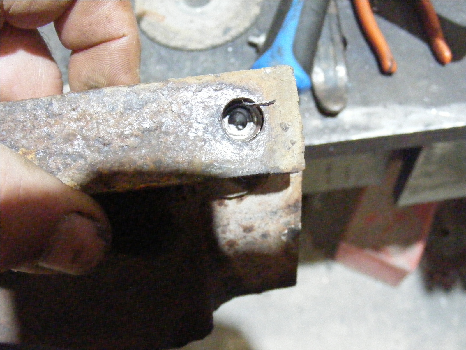

Below are some shots of the spacers for the crossmember just behind the transfer case. I have to remove these and move them over to the other frame. They were welded to the tractor crossmember and the whole unit rivetted to the frame. Since I am moving the crossmember forward, there is the need for these spacers. I am also showing why it is better to remove the rivet head before center punching and drilling. You just can't trust the peened end of the rivet to represent center.
Best bet is to get rid of the rivet head and center punch the shaft. I then like to drill around 1/8 about 3/4 the way through the rivet. I follow that up with a 3/8 bit, then knock it through with a punch and hammer. A pnematic hammer with punch are also good, but the neighbors will not like you and as well you lose the tranquility.

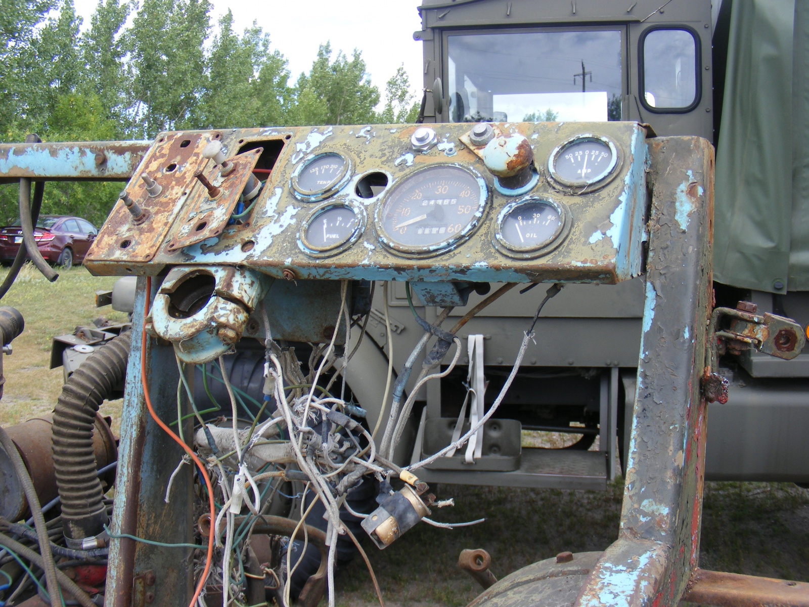

Amongst the many decisions to make now, is whether to keep this 8BA engine, or go back to one of the original Ww2 engines. I am leaning towards the 8BA but putting on the truck water pumps, the WW2 exhaust manifolds, and am tossing on whether to go back to the early distributor or retain the 8BA top distributor. In fact (for the weak of stomach, shield your eyes and ears) I am leaning towards making this a 12 volt vehicle. That will be a first for me.
Old 08-08-22, 07:57
I'm very hazey on this Rob, but should you consider putting the earlier heads on the 8BA (or vice verca) I understand you need to open up a couple of the water ports in the block? Apparently the new style starter bendix holds up better using 12 volts, with a 6 volt starter. A 6 volt instrument cluster would need a voltage reducer for fuel, oil and temp guages. It's easy. You can buy them for singles, or a unit that does all 3.
Old 08-08-22, 14:39
I can live with the 8BA heads (maybe), or I may do as you suggest. As to the starters, I have used a separate 12 volt battery on all my carriers over the years and never had a starter issue. Besides,starters are a fairly common item, and are also readily available online.
This is my first Ford with the round gauges, so I may end up replacing all or most with their equivalent in modern repros as used on the US military stuff.
Old 08-08-22, 15:09
Chev CMP gauges are dead wringers for Jeep, etc, and therefore modern replacements. The visible difference between the CMP and jeep/modern ones is that the CMP's have a flatter outer ring holding the glass on. The faces of Ford gauges are different (go figure). Example battery voltage instead of ammeter.
Old 08-08-22, 18:13
This one has an ammeter. Good confirmation on the gauges. These actually don't look bad, aside from the speedo. They may get restored, we'll see.
Old 08-08-22, 18:55
Watch out for the radium in the speedo if you take it apart, but I'm sure you know that.
Old 08-08-22, 20:19
Yep. Radium is pretty commonplace here at work. But thanks for the reminder.
Old 08-08-22, 22:50
Bruce, Rob, on the Ammeter verses the volt meter, the Australian pattern carriers had them both, but which was fitted depended upon which generator was fitted. The two brush went with one and the three brush, with the other. I don't recall which with which, but my guess would be the volt meter with the 3 brush?

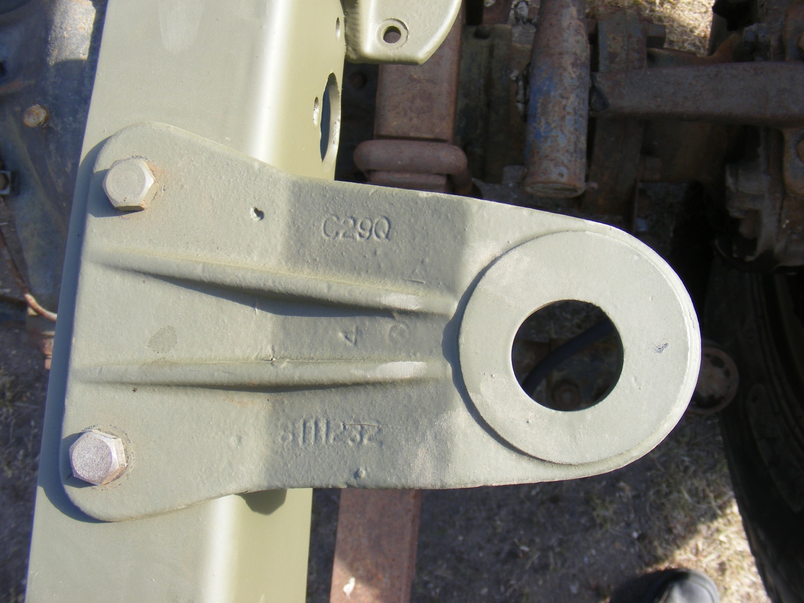

The frame is coming along, but I need to clear the yard before snowfall. We may have some wet flurried towards the end of this week, although permanent snow is still likely a month and a half away. But anything left on the ground will get plowed, so I put the axles back onto the frame (loosely) and placed the powertrain on pallets.
The frame was sandblasted and most of the required brackets have been moved across and bolted on. I also sandblasted and painted a couple rims and installed 4 tires that I had picked up last fall. They are a Chinese brand, but I think they look better than the US bar tread which I was saving for this project.
There is also a shot of one of the body mount brackets, showing where some worker was having a bad day. He was nowhere near on center. I will replace that bracket with one from the other frame.
I have new bushings for the front suspension and have ordered the necessary bushings and pins for the back suspension. I also found a couple of spare overload spring packs out in the lineup out back to replace the bent ones. I am also waiting for a pair of truck type waterpumps so I can install the engine and transfercase into the frame before winter.
I may not get my rolling chassis to the state I wanted it this fall, but at least it is mobile again.
