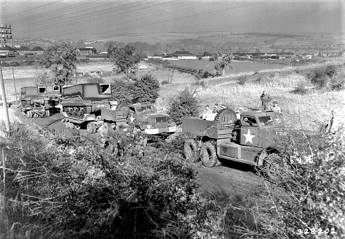

A wartime photo I have of Diamond T's struggling to get up the steep hill out of Marlborough, Wilts on the way south to either Salisbury Plain - or on to Southampton docks. I lived there and used to watch these although only 3 at the time!
But what sort of tank version are these - with the rather unwieldy upperworks?

They are M10 GMCs but with an added superstructure that was certainly not a recognized modification. There were standardized deep water fording kits available so I doubt if there would have been any point developing another version. Although an M10 is lighter than a Sherman I doubt that that box would have increased the displacement enough to make it float (like a DD) and the only other thought that I have is some sort of BARV, but the lighter weight would count against that as it would reduce the traction in the water. I will be fascinated to read any other ideas.
Old 02-02-24, 02:57
Posts: 2,323
Camouflage? A row of them in a field would present the appearance of a long box or a building instead of being obvious tanks... Just a guess.

But where's the gun barrel?

I suspect they are a box cover fitted before shipping across the Atlantic. The turret, being open topped, is more difficult to seal than a gun tank. The dark lines around the edges and the front hole looks like sealant. I assume the hole is to allow access without having to remove the entire box. The turret stows gun to the rear on the M10.
Agree, that's what I think too.
Almost certainly. Once you know how vehicles were waterproofed for shipping overseas, that black par-al-ketone sprayed along any seam that might leak is very obvious.

Correct Adrian - on the road to Amesbury then Salisbury. Where would this work have been done - not in this small Wiltshire town!

The waterproofing covers would have been fitted in the USA. The front openings removed after unloading from the ships.

Here’s a web site with scans of a booklet published by General Motors, that includes some details of how Shermans were prepared for shipping overseas:
https://usautoindustryworldwartwo.co...orsservice.htm
And a model I built a few years ago to show how a Sherman would have been waterproofed:
https://www.tapatalk.com/groups/miss...9888&p=1656069
The M10s would have had much the same work done, except instead of taping up the turret they seem to have had a big box structure built over the open turret.

One puzzle Adrian. These vehicles are headed south - towards Southampton presumably - and then on to France? So, if they arrived like this from the USA - how come they got to north Wiltshire en route? Maybe delivered to Liverpool or even Avonmouth - too dangerous to ship direct to Southampton perhaps - U-Boats and all? Then a long cross-country drive behind Diamond T's ? Ferocious use of gas - or diesel? Why not take the waterproofing stuff off on arrival to save some weight - or maybe want to keep it on for the cross-channel piece?
Note how one diamond T has uncoupled from it's trailer to double-head on the steepest bit - 10% grade there. Leaving a loaded trailer on a steep hill? Wow!

Diesel in the Diamond T but as to why etc, I don't know. I would imagine the box might be left on until landing in France but only if this were some time after D Day. I noticed the trailer. Either the other tractor has a problem or the hill is too steep for one. An M10 is not making the trailer fully loaded but it still might be a bad bit of gradient. The brakes on the Rogers trailer are very good, they work on all wheels and the parking brake keeps them on. They likely chocked it too.

I was back there last April -the railway station - two stations actually both GWR by then - in the background have gone (of course). The lower fields are now houses, a Tesco superstore and a gas station, The hill and Savernake Forest is still intact.
I have just noticed in the picture - if you look carefully - there is a line-up of about 8 more M10's on the road down towards the railway station. Quite a traffic jam - but virtually no civil vehicles allowed on the road anyway so I guess no problem.
