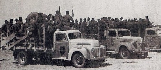

Folks,
Although I couldn't recognize a Ford-Marmon-Herrington to save my life (and thank God it has never come to it, too), mention of Leclerc jogged my memory a bit.
Would the following image be of a F-M-H? They're in service with the Grouppe Nomade de Tibesti in Tunisia.
Aris

Hi Akosion,
your GNT trucks are regular 4x2 trucks. your picture appears in the excellent and well-documented "L'Odyssee de la Colonne Leclerc", source of my information.
The 15th battery of the artillery of Force L in 1943 had 12 Marmon-Herrington trucks (page 167), the portee trucks (with 1897 75mm guns are mentioned on page 162 (artillery of Colonne Leclerc). No piccies of the trucks in this book.
Would it also be posible they had come from the French forces that had previously been at Bir Hakeim? I have checked the equally good (but more sentimental) "Bir Hakeim. la France renaissante book", to no avail.
Maybe on another francophone Forum?
Nuyt
Added later:
What we might be looking for is pictures of the vehicle nearest the camera (a 1942 Ford) but with front wheel drive by M-H.
That would make the truck sit much higher at the front. The front mudguards might be different ("shaved") to allow for more space for the front wheels.
