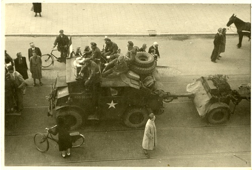

I'd like to invite opinions on this being a Chevrolet C-GT or Ford F-GT

Tried to blow up the front bumper area to look for the horn and the shape of the brush bar, but picture is to low resolution to really tell. Tend to think it is a Chevy though.
Old 30-03-05, 01:44
It doesn't have that extra bar across the grille or the overflow tank so I'd go with Ford.
Old 30-03-05, 01:50
Default Yep
I agree David - also it looks like a short bar on the brush guard so it looks to be a FGT.

It's not being towed- must be a Ford for sure!

Yes, if you have a look at the people, some have turned so they get the full stereo effect as it drives past; the person lower right is watching the next FGT coming and pondering what she has to do to score a ride...

Ford no doubt about it,
If you look closely you can see the lady with the bike asking if the crew need a tow, as that poor old short stroke V8 whispers to a stop with the obligatory overheated coil and vapour lock.
Man looking the other way "Mine Got seze Fords vay are so quite zay must be a stelth veapon......Ach it's stopped !!".
It's a Ford

Looks like a Chev grille-guard to me...

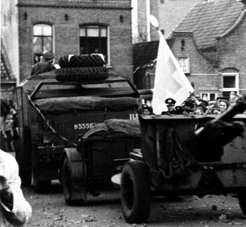

I keep trying to read the Census Number. It appears to my poor eyes as though it is H 55etc. and on that basis may I suggest either of two series:
H 5558176 to 5558375 SM 2546 F.-G.T. Ford Model C291Q F-GT... late 1942 delivery or 1943
However HISTORIC MILITARY VEHICLES DIRECTORY P. 52 has a photo of a Chevrolet FAT marked up as ‘H5558307’!
and
H 5570919 to 5571047 SM 6064 C.-G.T. Model 8440 which would be from 1944???

If in Australia this truck would be a chev as the fords here have Two small hand grabs on the roof, I dont know if your Canadian trucks are the same as the Australian trucks in this feature
Greg
Old 31-03-05, 21:05
Default grab handles
It's only the Aussie built Ford roofs which have those grab handles, Greg.
and
The picture on the top of this thread is one of the FATs in use with the Dutch Prinses Irene Brigade. David, I agree on the "H55" census number on the door. Can't tell is the third digit is 5 or 7, so this does not help to determine if it a Ford or Chevrolet.
The picture in HISTORIC MILITARY VEHICLES DIRECTORY P. 52 indeed has a photo of a Chevrolet CGT marked up as "H5558307", this number was copied from a wartime photo of a FAT of the Dutch Prinses Irene Brigade. Up till now no-one is really sure about whether this Brigade's FATs were Chevrolets or Fords. Difficulty is in the fact that the Prinses Irene Brigade had a wide range of vehicles, it seems they were handed all the left-overs from the British Army. The evidence available suggests Ford FGT, as seen below.
Source: beeldbank.nationaalarchief.nl

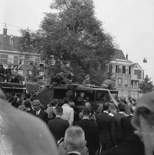

As endorsed by this census number in the "H555" range.
Source: www.gemeentearchief.denhaag.nl
Fotonummer 820711.01
Caption: "Bevrijding. Intocht van de Canadese troepen en de Prinses Irenebrigade op de Hofweg." (Den Haag)

Here is another CMP FAT of which I don't know if it is a Chevrolet or Ford (but note the typical "Dutch stowage" ).

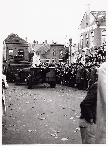

At the regionaal archief Tilburg website, another photo of a CMP tractor can be found:
http://regionaalarchief.tilburg.nl/i...PhotoID=012610
It's possible to zoom in on the census number: H555(6 or 8)...

Funny thing is that your URL does not work, until one has looked up the picture using the photo number first. Guess it has something to do with caching.
Anyway, I zoomed in and took a screenshot. I'd say it is H5556...
