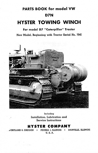

A minor part of these bulldozers, but I found PDFs of original manuals for the winches used on the D6A and D7A:
Name:	Hyster D6N Towing Winch.jpg
ID:	129601 Click image for larger version
Name:	Hyster D7N Towing Winch.jpg
The serial numbers indicated are technically not for the armoured versions, but the D6A was basically a D6-5R with an armoured cab and hydraulic dozer blade and the D7A was a similarly modified D7-7M, so I doubt the winches would have been very different.
Edit: I just realised that site is making linking to the right page difficult. In the menu on the left, choose Allied Winch → Operator’s Manuals → Archive to find the ones I mentioned above.
Old 02-08-22, 15:21
Posts: 14,971
Default Allied Systems Company archive
Nice find Jakko!
Good to see some manufacturers still provide this sort of information to the users of their products.
Old 03-08-22, 12:20
Join Date: Apr 2020
Location: Netherlands
Posts: 374
There is probably more stuff there that some restorers might find useful, but I didn’t really look beyond a quick glance.

Jakko, There were other options for winches (for those who dont know) There were (Carco ?) twin drum winches used on "cable controlled" equipment. Some Cats (D7) had cable controlled blades and a second drum was used to operate the bowl on a scraper. I assume the millitary dozers used in airfield construction were fitted with them?
