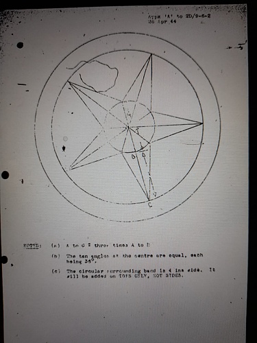

Old 19-10-05, 02:45
Steve Guthrie's Avatar
Greybeard Member
Posts: 281
Default White Star drawing..
Hello Hanno
Here it is
Steve
SECRET
2D/9-6-2
HQ 2 Cdn Inf Div
16 April 44
VEH MARKINGS
Recognition marks
White stars five pointed
1. The m/n recognition marks will be painted on all ‘A’ and ‘B’ vehs, SP guns and mob mech eqpt. RAF and vehs and eqpt (marked with the Geneva cross) will not carry the white star.
2. All amd vehs (include. SP guns, carriers, half tracks, trucks 15-cwt 4x4 personnel, White scout cars) will carry the recognition marks on the top only in accordance with para 4 below.
3. All vehs and eqpts other than armd vehs will carry the sign on the top and both sides in accordance with paras 4 and 5 below.
4. On the top of the veh or eqpt the mark will be painted on the largest horizontal or near horizontal plane surface. It will NOT be carried on the cab over the co-dvrs seat (to be holed for AALMG). It will not be carried in a posn that is liable to be covered with stores, stowage or eqpts.
5. On sides it will be carried on vertical or near vertical plane surfaces NOT usually covered by fittings and eqpts.
6. Size
(a) Top - as large as possible but not less than one foot measured from center to outside of band.
(b) Sides - as large as possible but not less than 3 ins measured from center to tips
(c) If space does not permit the above minimus sizes no marks will be carried
7. Requirements for white lead GS paint (Cat. HA0293) will be submitted by units to the ADOS office. Indents will indicate the purpose for which the paint is required, number of vehs to be painted and minimum requirements for paint. No background paint will be issued.
8. The present recognition (Red White Red) marks used on AFV’s will be removed.
9. Appx
10 Recogniton marks will NOT be painted on canvas, canopies or tarps
(Signature)
(J H Adams) Maj
DAQMG
for AA & QMG 2 Cdn Inf Div
Note The circular surrounding band is 4 ins wide. It will be added on TOPS ONLY, NOT SIDES.
WW2 Canadian Army Vehicle
Camouflage and Markings

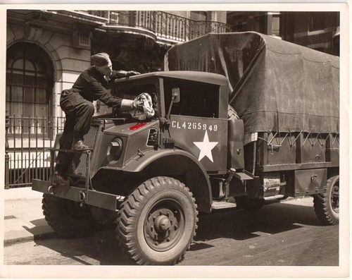

Old 01-12-05, 18:59
Posts: 14,969
See this interesting pic on eBay: WWII Allied STAR ID Canada Post Truck Pre-D-Day Photo Item number: 6584331830
An Original & Authentic 8 x 10 Inch US Army WWII First View of "Liberation Star" Insignia For D-Day Invasion May 1944 Dated Official Signal Corps News Period Photograph.
This photo shows the white star, designated as the identification marking of the liberation forces to be deployed to the ETO at Normandy. The star was used on all Allied ground forces during the rest of WWII. Note the truck is Canadian. The location is England, just before the invasion. The unit marking is censored for deletion, indicating the truck was assigned to the Canadian Postal Corps.
Old 02-12-05, 01:43
Greybeard Member
Posts: 281
Default Postal what?
Hi there
3rd Div postal unit had a AoS of '80' white on black, 4th Armd Dive had a '44' ditto. 2 Corps was '84'
Can someone see under the censor's mark?
It should be a formation sign, but which one?
I wonder what the date is? May 1944 jives with the 'Liberation Star' but what about the Field Service cap the squaddie is wearing?
I wonder why the US Army Signal corps took a picture of one of our trucks?
Steve

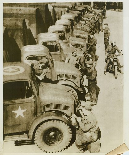

Default U.s. Star marks allied invasion vehicles
"NEW YORK BUREAU
U.S. STAR MARKS ALLIED INVASION VEHICLES
ENGLAND – The five pointed white star which, until recently, marked trucks, tanks and other vehicles of the U.S. forces, will mark all vehicles of the Allied Expeditionary Force for the forthcoming invasion. An example ofh the complete integration of men and equipment under the command of Gen. Dwight D. Eisenhower, the “invasion star” here, (above), is shown being painted on British Army vehicles “somewhere in England.” This photo was radioed from London to New York tonight.
Credit: Acme radio photo 5-31-44"

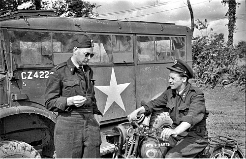

Old 19-09-20, 11:32
Posts: 14,969
C8A with 2nd TAF, Normandy 1944. Notice how the white star is “squeezed” making it look thinner.

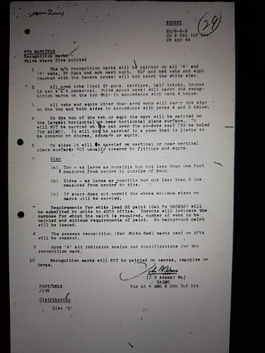

Old 10-11-22, 11:57
Posts: 14,969
Default 10 days later the template was changed
Originally Posted by Steve Guthrie View Post
Hello Hanno
Here it is
Steve
SECRET
2D/9-6-2
HQ 2 Cdn Inf Div
16 April 44
VEH MARKINGS
Recognition marks
*snip*
Tim Bell posted the same document 2D/9-6-2, HQ 2 Cdn Inf Div, but dated 26 April 44. Interestingly, it has another version of the template for the white star attached.
ID:	130612 Click image for larger version
