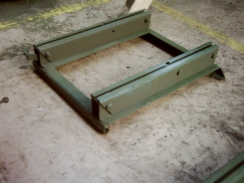

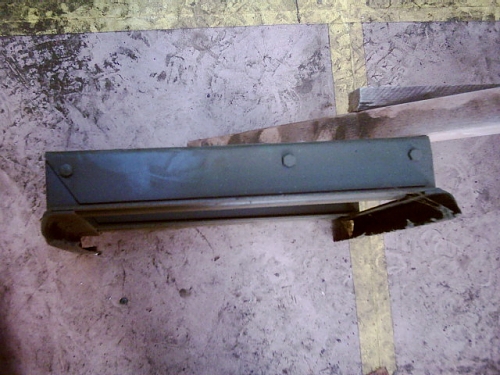

Some of you may be following my restorartion of my 1942 C15 4x2 and I need some help with some photo's / dimensions of the rear stowage box's fitted to the underside of my wood / steel composite Gs body on my truck.
If anyone out there can help it would be greatly appreciated also some nice detailed photo's of the inside of an early 13 cab would be very usefull I have two styles of seat frame and am not sure which is the correct one to use.
This one sits on the floor the second type has C section welded to it and therefore sits higher see other pic.

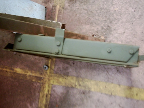

Heres the second type of seat frame
Slightly different view
Again a different view.

The seat frame that sits on the floor is the one used in 4x2 blitz's
the other one is used in 4x4. That's we find down under in our chevs.

I've not come across the raised seat base before, my 42 C30 has the frame that sits directly onto the floor, and is quite high enough for driving.

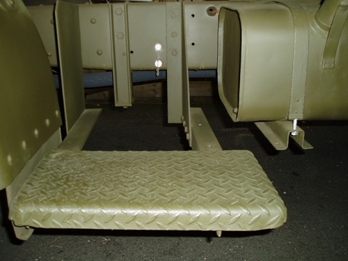

If you could email me some photos of mirror arm attachment to door hinge, seat frames to floor, rear cab panel to edge of door, edge of cab roof to top of door opening, piping to windscreen wipers various views of dog kennel plus left and right cab steps inc battery box, if you could give me the height from ground to top of tread that would be of great help.

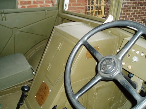

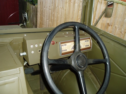

Image #1 - # 5

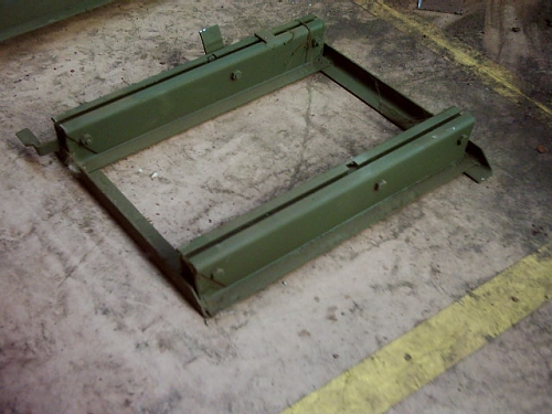

Image # 6
By the way, does anyone know what the 3 holes are for on the last picture, by the floor plate (Before anyone replies, I know there are only 2 shown on this image!)

Keith are you kidding......
... the biggest problem is all the salivating on the keyboard...... particularly at the office......
Your pictures are an inspiration......
So what are the 3 holes that only 2 are showing???
Inside the cab..... upper corner.... is that right angle brace original??

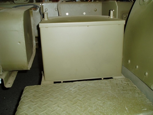

On the battery box..... what are the fasteners holding the cover together..... looks like some rubber tubes have been plugged over the thread portion...??
..and finally.... (it's all your fault with your pictures) where did you get the nice instrument panel.... is this a "Salesman Bob " issue...??
Bob C.

I'm intrigued by a couple (or 3) things:
1) The side window frames have a clip by the canvas section, is this a lock?
2) What is the clip on the cab back panel above the drivers seat?
3) What is the surfacing on the rifle clips? were they rubber coated?
I have not seen the canvas bag for the window screens at all.
Would you please post a photo or two with basic dimensions?
and Bob,
The battery box cover looks just like the one described on another thread in MLU: (another job for me to complete.)
The L shaped stiffener by the top rear of the cab doorway is present on all the trucks I've seen
Sorry I have no idea of the holes in the side of the cab floor frame either!
Rob

Hi Rob, Bob and RR,
Apoligies for the late reply to all of your enquries, I'll try and answer the questions in some logical order.
Rod, Yes, this is a clip, my own adaptation, to stop the access flap opening when she is on the move. The only snag is, is that if you leave it locked when you depart from the cab, you can lock your self out !
Clip above the drivers seat, I don't know. It was there when I purchased her, and when I took it off, original paint was found behind it, and on the rear of the clip. So i bolted it back on in the hope to find the answer one day !
No, not rubber coated, they are leather coated complete with very neat stitching, although I'm sure I have another one which is rubber coated, I'll check this out.
Look at picture #2 which shows part of the side door storage bag. I'll post a couple of images and dimensions shortly. The bag is original and came from Brian Asbury in Canada.
Rob, you are correct with reference to the L shaped stiffner
RR
The canvas sections (all of which are different profiles), and the flap used on my half doors were supplied by Allied Forces Bristol, who had my original sections, as patterns.If you don't have their number, let me know. The perpex came from the local DIY shop. A word of warning, allow yourself several days to reassemble the sidescreens, as it is very time consuming !
Bob,
Thanks for your kind words, during any of my restorations , I always aim for original correctness.
Rob is correct with reference to the L shaped stiffner
The fasteners for the battery box are a captured 'T' type shouldered bar, which screw onto a couple of threads, just below the underside of the top of the battery box. The rubber tubes you mention, are actually steel shoulders forming part of this fastener. The complete battery box was fabricated from scatch during the rebuild. Check out the other links on MLU on battery boxes.
The instument panel was built up over a couple of years, from bits and peices bought at various venues, (I seem to remeber the glass came from Belgium, and the head came from Holland)and then spent two years in our bedroom (for safe keeping, although I was often caught drooling over it by the wife !) So no, salesman Bob did'nt get involved with this one (sorry Bob)
I hope I've answered all your questions, if there are any more, please let me know
Keith
