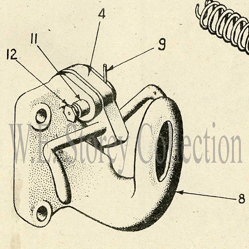

Here is a segment of the Perch image from the Q.F. 25-Pr Identification List.
Name:	134B. Perch.jpg
Old 05-11-17, 23:44
Posts: 7,623
Interesting Ed. My 25pdr parts manual is a fairly late edition, and shows the regular hitch. Perhaps I'll have to look at the limber closer and see if there is a date.
What vintage is your manual Ed?

Old 06-11-17, 02:47
Posts: 1,731
Default More Pintle Hooks
This image is from a 1939 Gun Drill Book.
Name:	Gun Drill for Q.F. 25-PR.jpg
