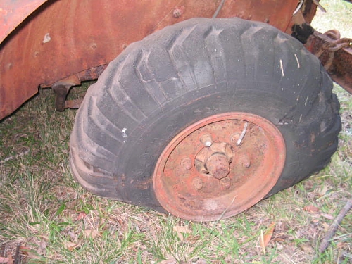

The original tyres still HAD good tread before 60 years of sunlight got to them. I think a visit to This thread is in order.

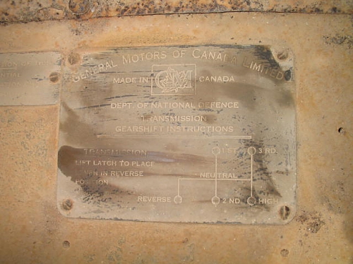

There were no data plates to be found giving a serial number, but some of the instruction plates are still there

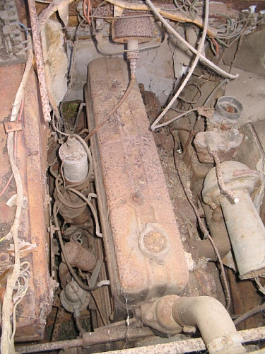

The only possible identifying number to be found was the engine number (seems to be the original) which was R1977950. Odd, I thought Chev numbers were PR... or TR....
David Hayward, any clues here?

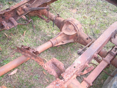

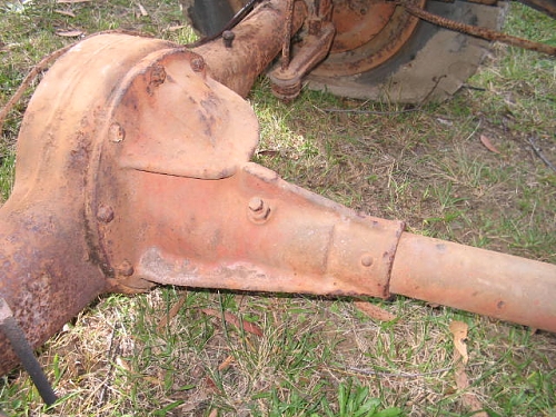

As we have discussed in other threads before, Chev C8's and C15's tend to draw components from Civvy commercial vehicles much more than other CMP's.
Here we see the rear Chev Torque Tube diff (and some genuine Chev chassis rust).
The diff is sourced from the Chev 1/2 ton truck:

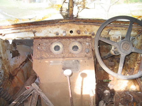

While the instrument panel has been replaced by something equally vintage but civvy, the rest of the Cab interior remains fairly complete and unmodified:

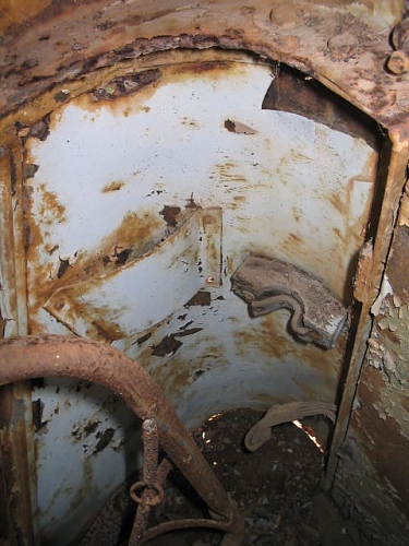

The inside of the left rear corner of the cab has these brackets remaining. The is one in the upper part of the wall that appears to be for a maintenence manual or logbook, but what are the lower ones for?
The wedge shaped one looks like the type used for blades of shovels, but this would only fit a small garden trowel.
Is the felt-padded block with webbing strap a Rifle retainer?

Default Interesting!
R1977950
I think it could only be a 1939 Model Canadian car 216 engine, rhd of course, perhaps out of a Holden Chevy! Might be worth some $$$ to a '39 owner somewhere around the world. The casting date code and the blocks casting code will confirm.
I believe that these are ex-Canadian C.8, F.8 and C.15/F.15 trucks assembled in the UK and then sold to the British, acquired under BM/2V83.WS6 (D) or BM/2783.WS6(D) and shipped out to the Mid-East, for allocation to forceds out there. They were then allcoatd Census Numbers in the local Z 417 etc series, e.g.
Z 4177535, and then of course transferred to the AIF in due course. They were then repatriated to Australia subsequently.
Phew!

Default Instuments
Look to me to be out of a 1934 Chev car, one of those ordinary civilian things.

The rear axle and rear springs is a actually from the 1939/40 civvy 1 ton truck with 4.55-1 ratio . There are a few C8's around , another one lives near Drouin , not far from here .

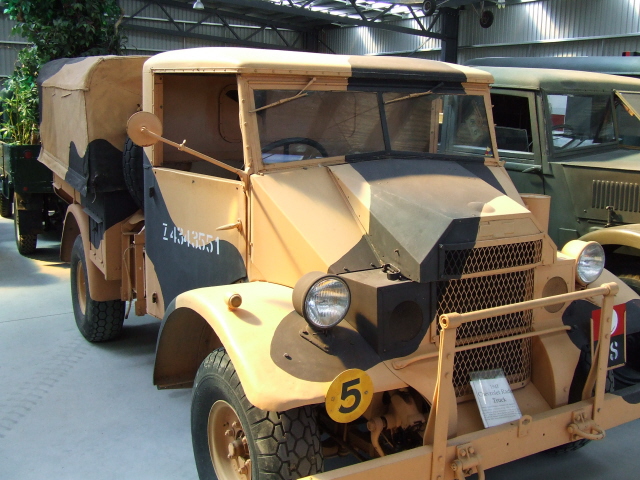

Originally posted by aj.lec
the one in dubbo was a ford
dont know where it ended up it was presold before auction
Picture of the Dubbo C8:

The 13 WD rims for the rear were supplied with the vehicle, but not the spacer/adapter to convert from the Chev 6 on 5 1/2 bolt pattern to the WD bolt pattern. The truck is now on CHev commercial wheels, but will probably receive a pair of Toyota Landcruiser wheels to roll on.
What does the spacer/adapter look like, and would anyone have a pair spare?

Herer's the hubs and adapters off my C8. The one on the right is the rear wheel adapter. The front ones are the whole hub and not just an adapter. To use the 6 on 5 1/2 wheels on the front you'd have to install a half ton spindlle. I think the king pins are the same.
The problem with civvy wheels would be to get them positioned at the right width for the truck. The adapters are about 3" wide so if you remove them the track width is 6" less. If I was doing this I'd get some machinery rims that use the 7 rib 11x15" tires. These are the same profile as the military tires and are only 1 or 2 inches more diameter. Then I'd cut the centres out and weld in centres off a 6 bolt Chev with the rim offset outwards as far as I could get it. You'd end up with the right shaped tire sitting in the right place and you'd pick up a couple of mph to boot. You could also groove the tires at right angles to the ribs if you wanted the tread.

stand corrected
didnt see that one was gone before i got there i think
only saw this one
Have a good one
Andrew
Old 04-06-07, 13:14
Default This one
stand corrected
only saw this one
Looks to be a F15.

The chassis of the C8 is interesting , they seem to have used the middle crossmember from a 1940 1/2 ton pickup . The same crossmember is used on the C8AX chassis too. I measured all 3 crossmembers of my three vehicles here:
C8
C8AX
1940 15 cwt ute ( or 1/2 ton pickup to others )
All 3 have exactly the same middle crossmember dimensionally , it's the curvy one that is rusted away in Tony's pic. I also have a 1939 Chev 1 ton wreck here and it also has the same crossmember fitted.

Funny to see that the crossmember rotted away completely while other chassis elements still remain. Maybe a result of (too) heavy load and damage to that part?
Old 04-06-07, 17:06
Alex, I think it may have more to do with the type of body that was fitted post-war, or the way it was mounted. The rest of the chassis is quite good away from the crossmember, but there is a heavy railway sleeper bolted across the frame just behind the cab. Perhaps there was a similar piece of wood near the rusted out crossmember?
